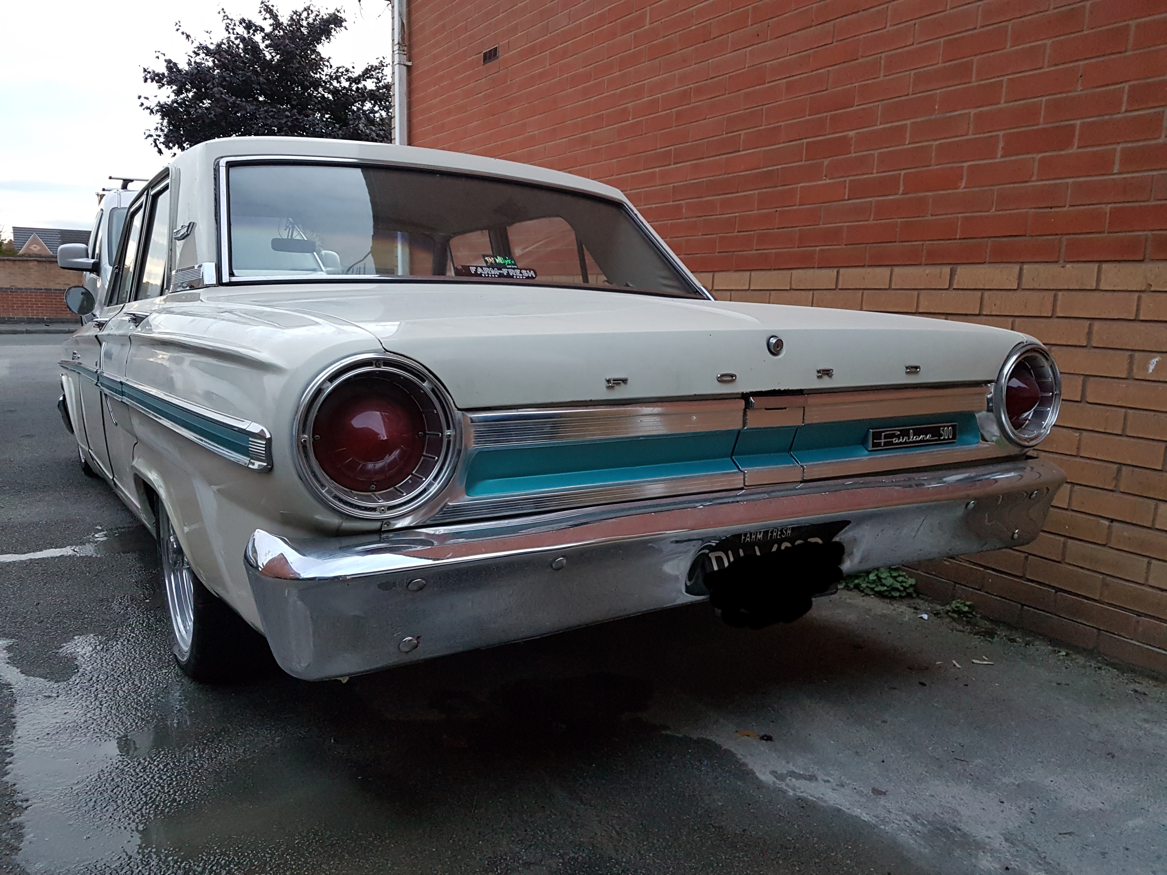

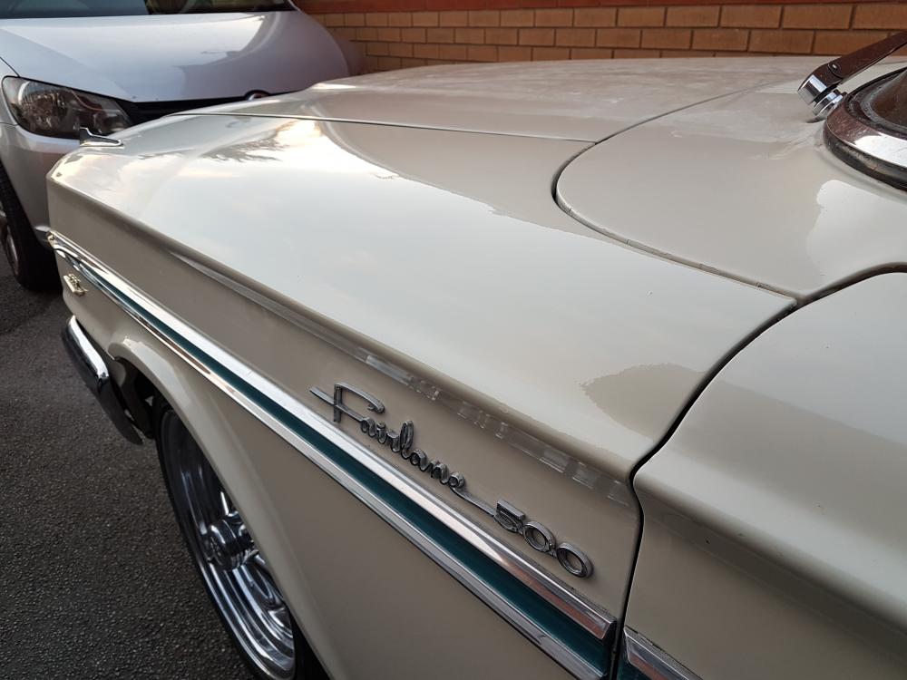

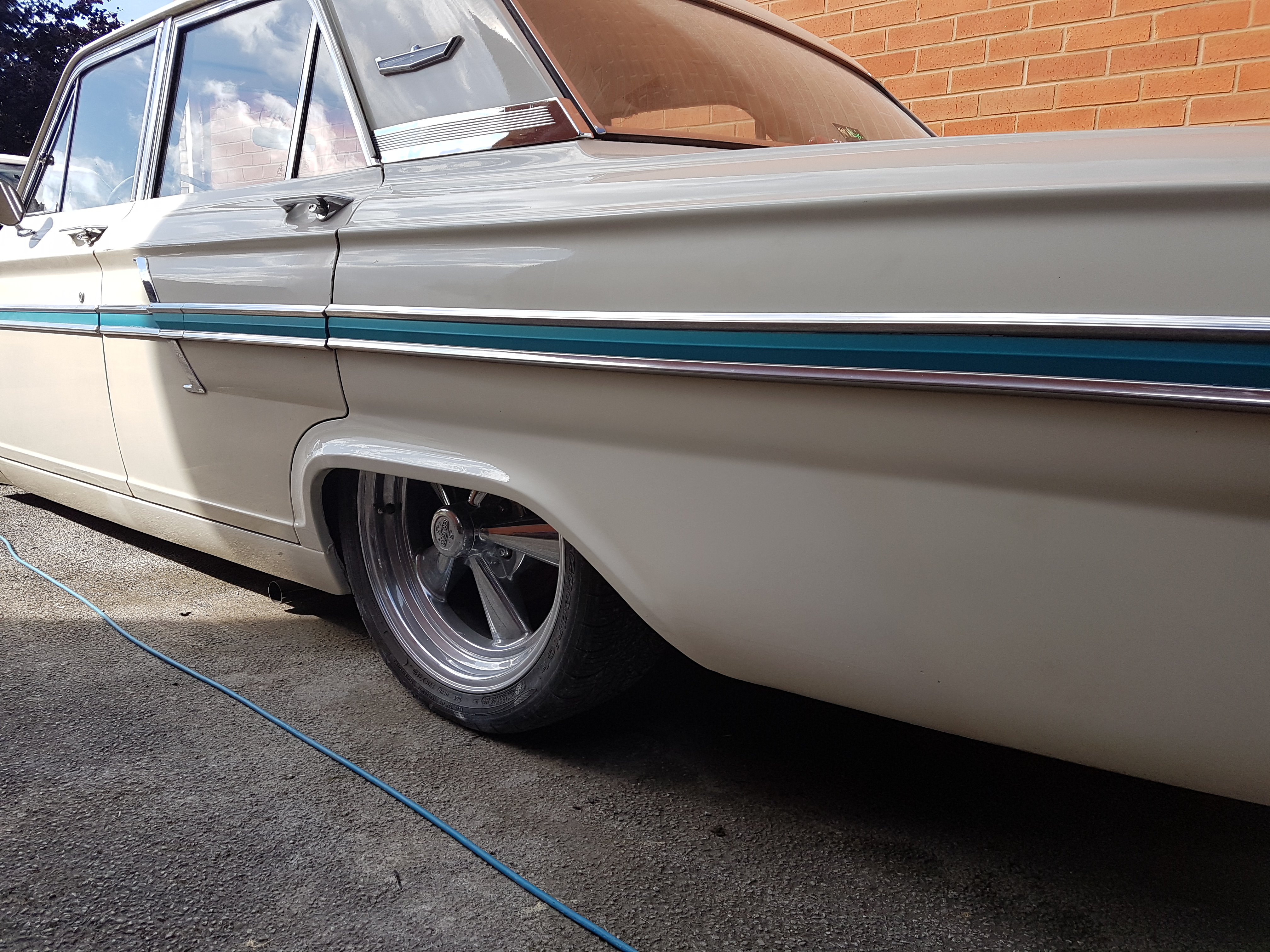

Back quater painted up, colours off a little it's abit to yellow but it's water proof for now, just need to buff the blend in. The rear n/s trim had a caravan plug through it when I bought it so I've had that welded up and I've painted it turquoise to match the sides now. It's getting there!

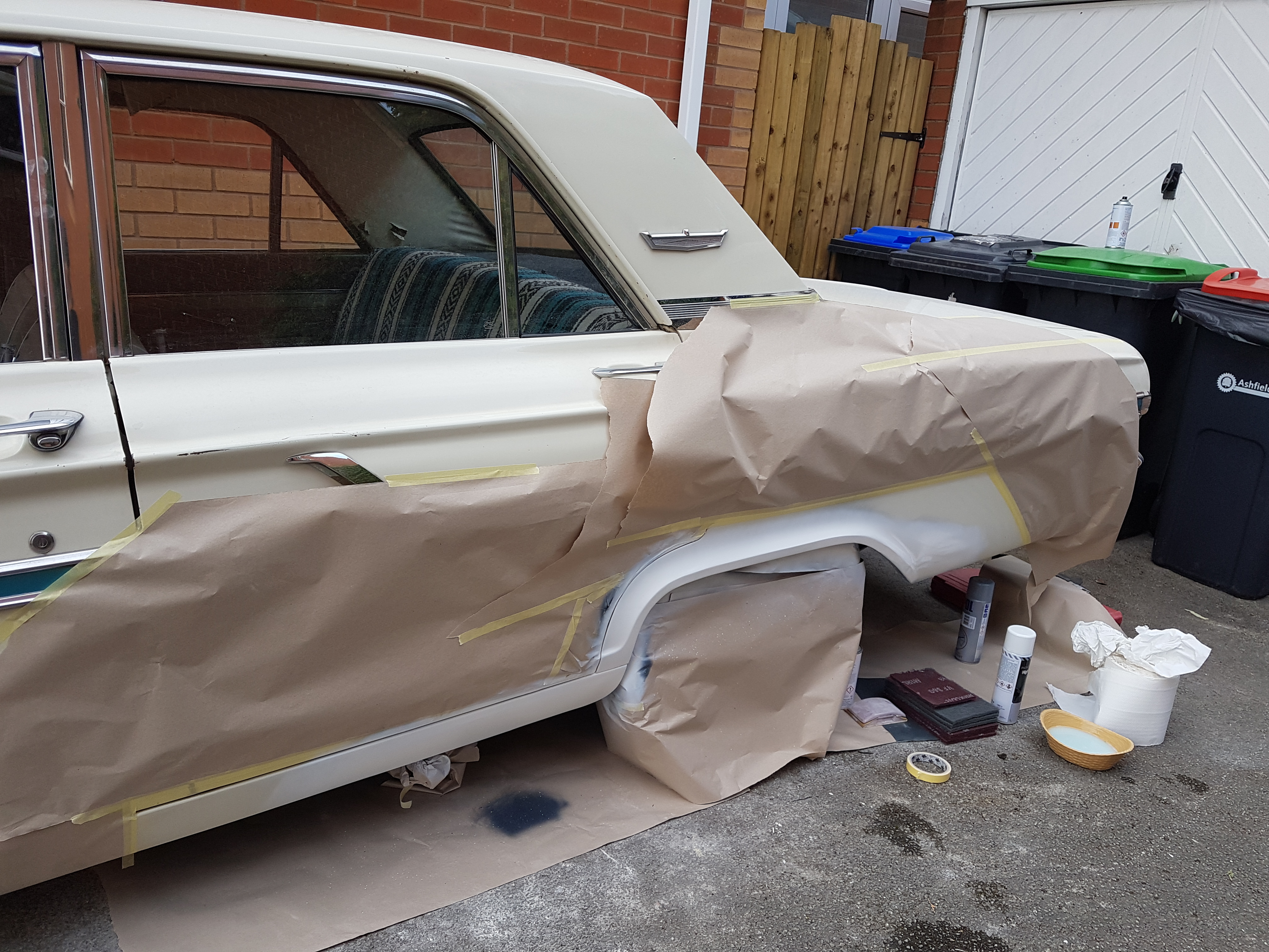

Bodywork time.. Ariel hole filled and painted... I'll be painting the arches at the weekend, then while it's off the road I'm gonna whip around with aerosols and tidy door shuts up and the likes. Ordered a MK2 escort rack tonight in RHD and I'll flip it so it's correct for mounting behind the hubs. It's the correct length more or less so should provide a good base and keep bump steer down. Need to asses my options in terms of how to joint the column to the rack, it'll inevitably be a length of rod and 2 UJs but I'll need to develop a support for the engine bay end of the column..
