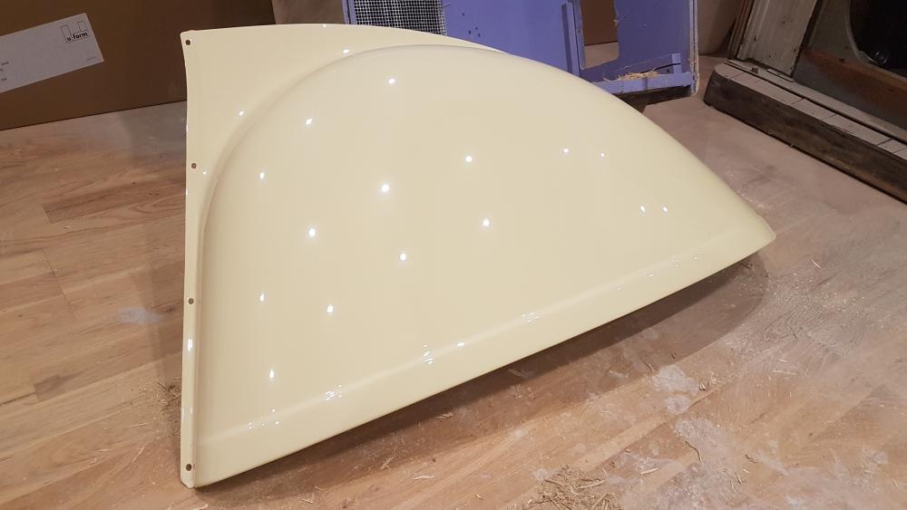

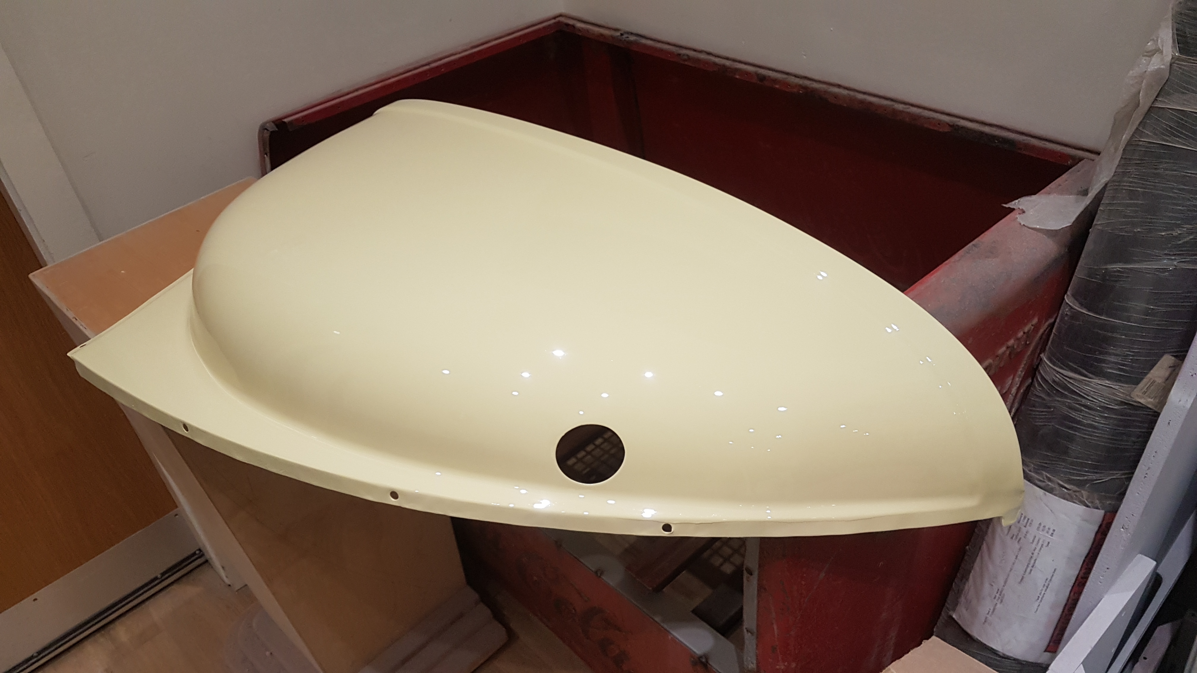

Nah no worries man. If rather help people before the job then try and remedy it after haha. Yeah if 100% just stick with solid colour for.your application. If your used to painting 1k poly, other then adding hardner into the mix there's nothing more too it. Just get a tech sheet on your paint when you buy and you'll be good to go. Best advise too is just practise and learn how far you can push the material before sagging or runs, just get a scrap wing and have a play and figure your gun settings etc before you get onto the car. I painted these for Jenny's dad the other day, a pair of new wings for his 2CV. I don't paint much car stuff but always enjoy it when I do..

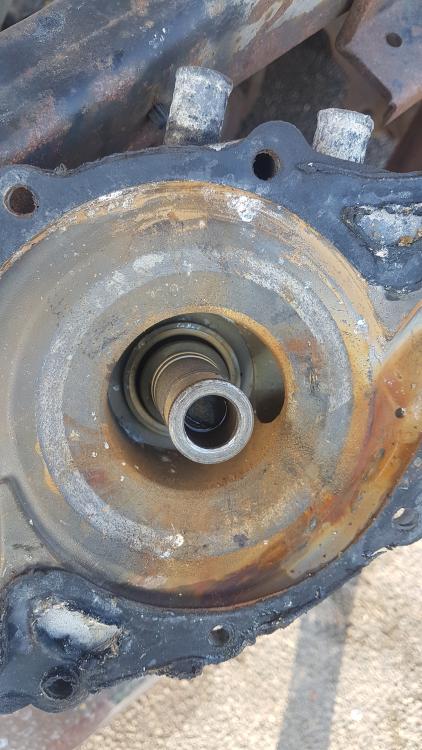

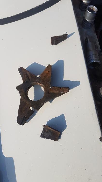

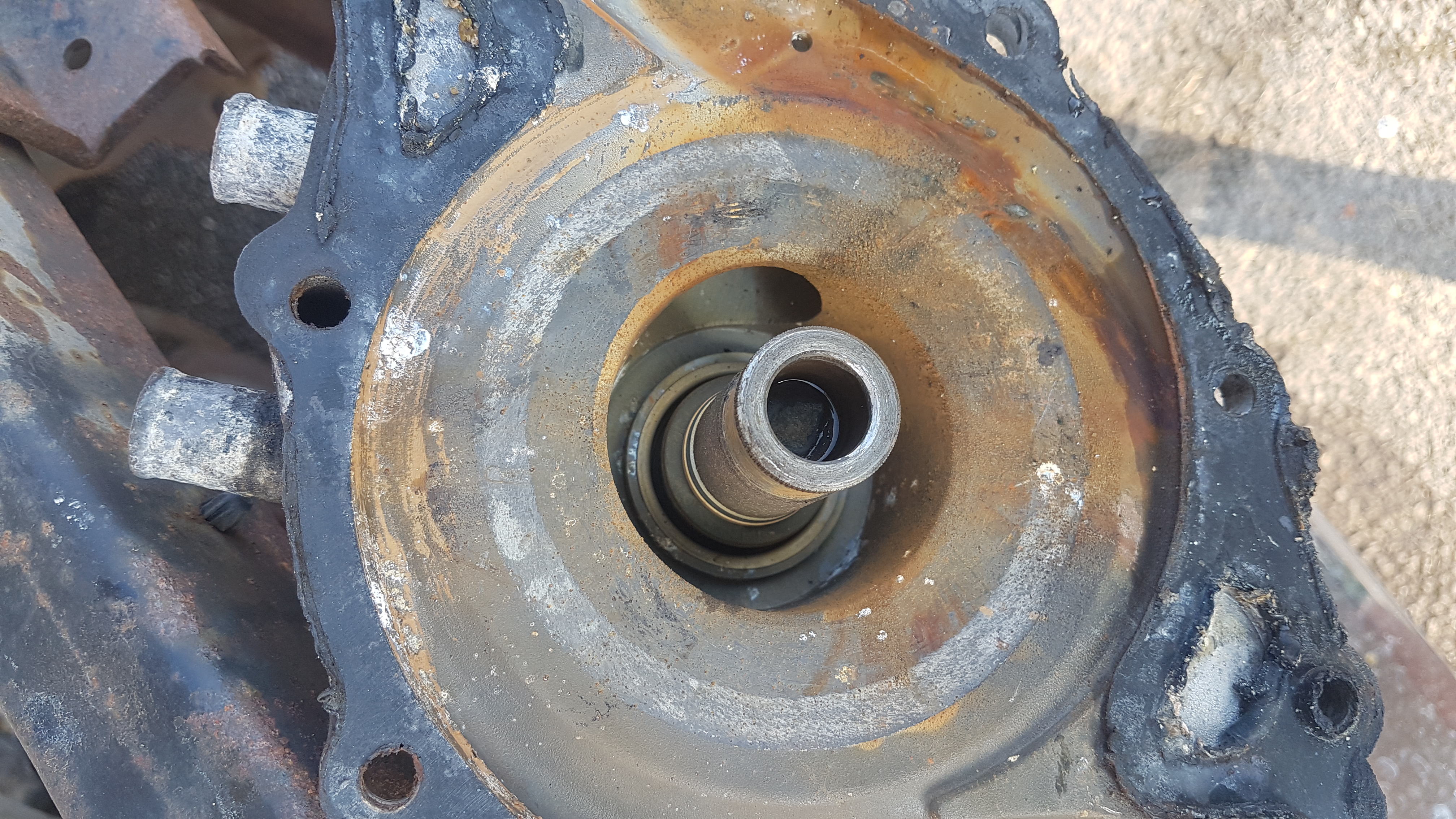

The Fairlane was still getting abit warm on runs, so swapped the water pump and all hoses anyway.. Found the reason for the warm running.. Impeller had come from the drive shaft so was just doing nothing, then I guess when the impeller came off it shat 2 of the blades that were cloging up the water way. It's a miracle it lasted so well!

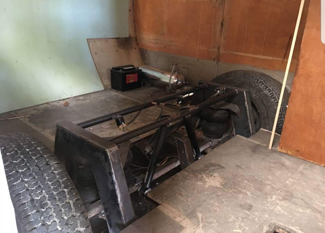

Mike, yes, but trying to hash out the deal really. I'm not getting hold of it till October time though. The guys in no rush and I want my fairlane for my wedding. The caravan was with it when it came into the country, got split in the deal as it was too much. Caravan was on air too Just discovered it has a rebuilt Ford 390 in there with some silly cam, edelbrock inlet and holley carb and some awesome headers. The fairlane is only a 289 (4.7l) and that goes like a rocket, this things a 6.4l with goodies so should track along nicely!
