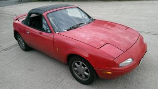

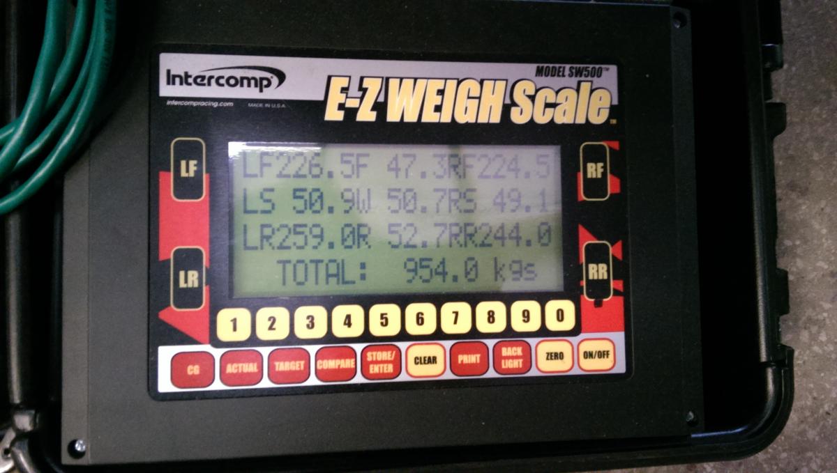

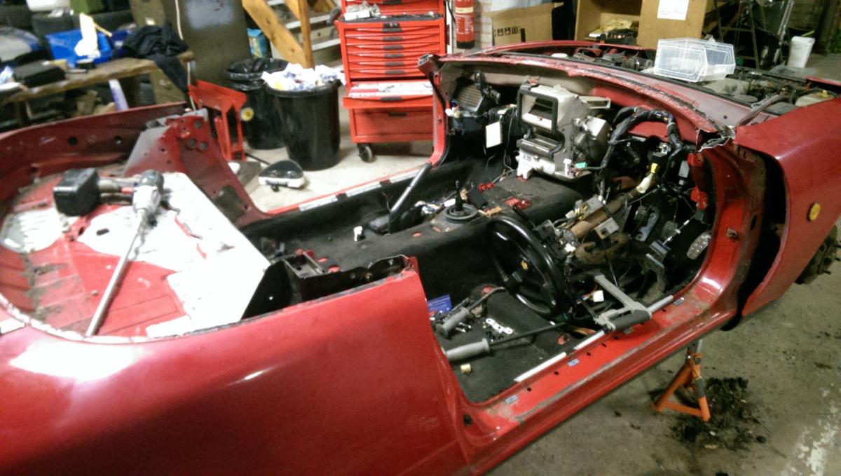

  5. Some progress today... A photo from the bad side (missing wing mirror and window that won't stay up): Got some free CDs and a lovely cushion: The weigh in (ignore individual corner weights): 3 hours and 2 skinned knuckles later:

  9. Haha, pretty much. It will already do that as it is but want to take it a bit further! Loose plan... Strip the hell out of it (reckon I can shed ~150kg), cut the windscreen off, DIY build a roll cage, fit some 13" wheels and used slicks, GRP seats, harnesses, service it, fill it with decent fluids and then spank the shit out of it No engine mods at all.

  22. My race car is about 868kg, that's with a 46kg cage in it, full dash, no lightened body panels and 15" wheels - so 850 should be fairly easy I think, yeah... Westie is expensive to run (comparatively), and I feel bad spanking it non stop on a track day And I want a project...
