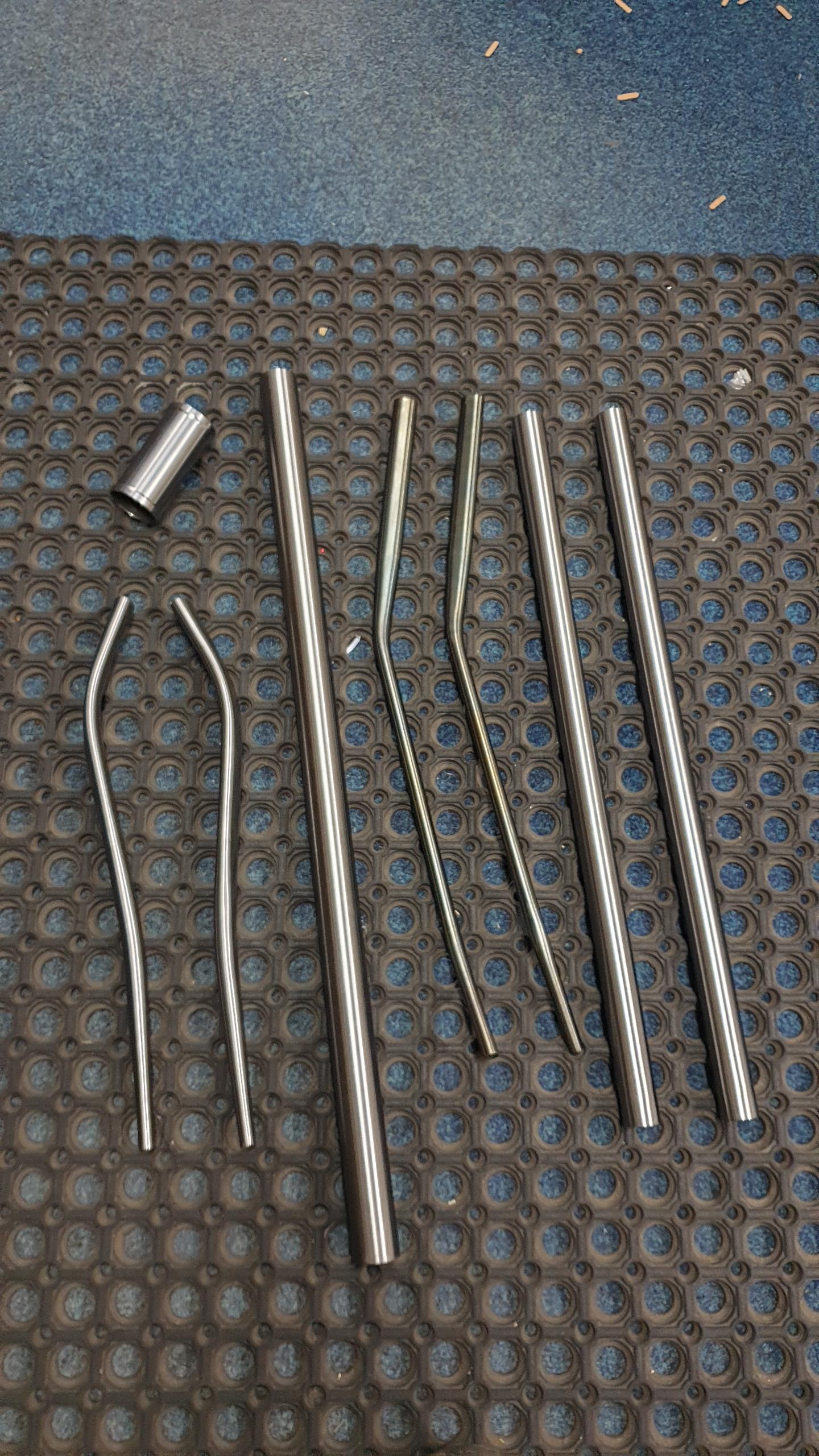

Some good advice there ^^ Anyone can make you a frame, doesn't have to be trials specific. I just got a set of tubes from Ceeway, good service and decent prices too. Would probably get plain gauge 4130 for your experiment. That said, I have put nearly a year on an MTB frame I built from super cheap 1.2mm mild steel, and Flipp has built frames from it in the past too. Works fine if a bit heavy and dead-feeling.

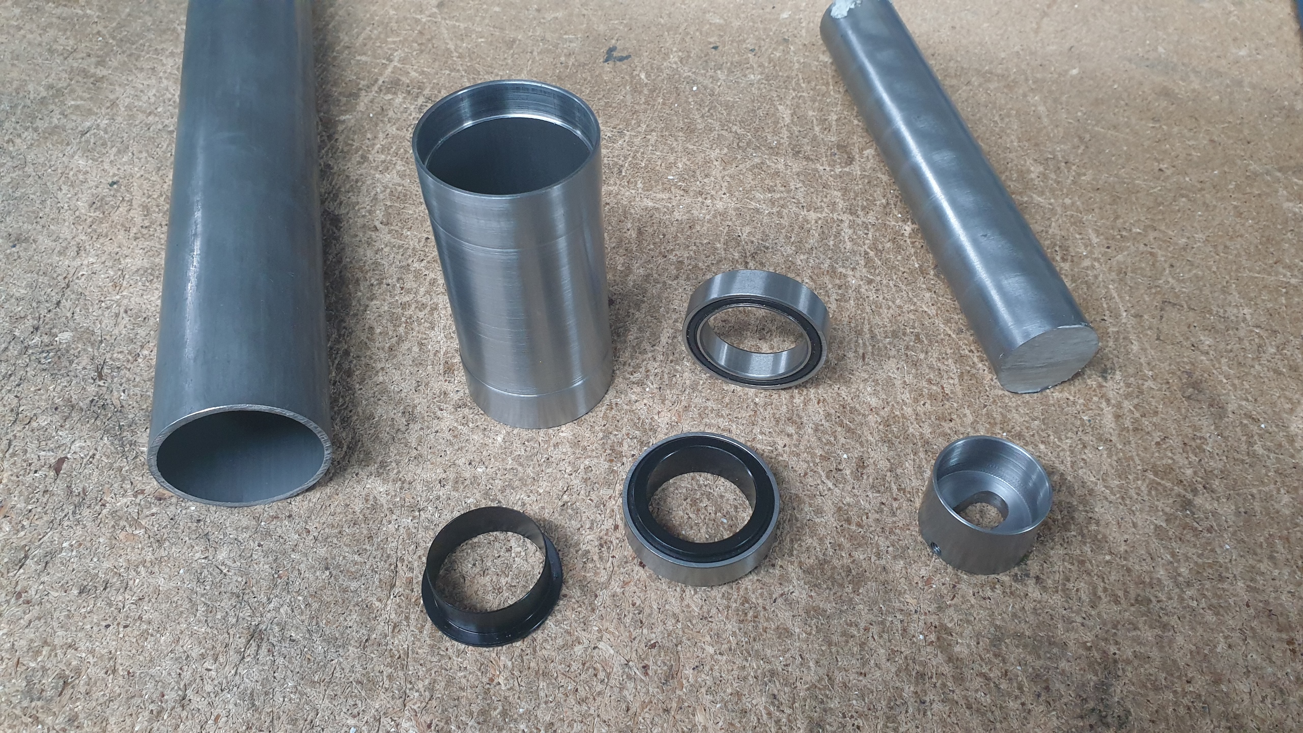

Thanks for your input guys! I also think eccentric BB would be easier for adjustment - though in considering this, it has made me ponder why the eccentric system at the dropouts is awkward. Yes you can move the wheel around, but only on a prescribed circle. You can't just nudge it directly up a bit here, or horizontally back a bit there, for example. So, I've come up with something else that may or may not work, we'll find out in a few weeks
