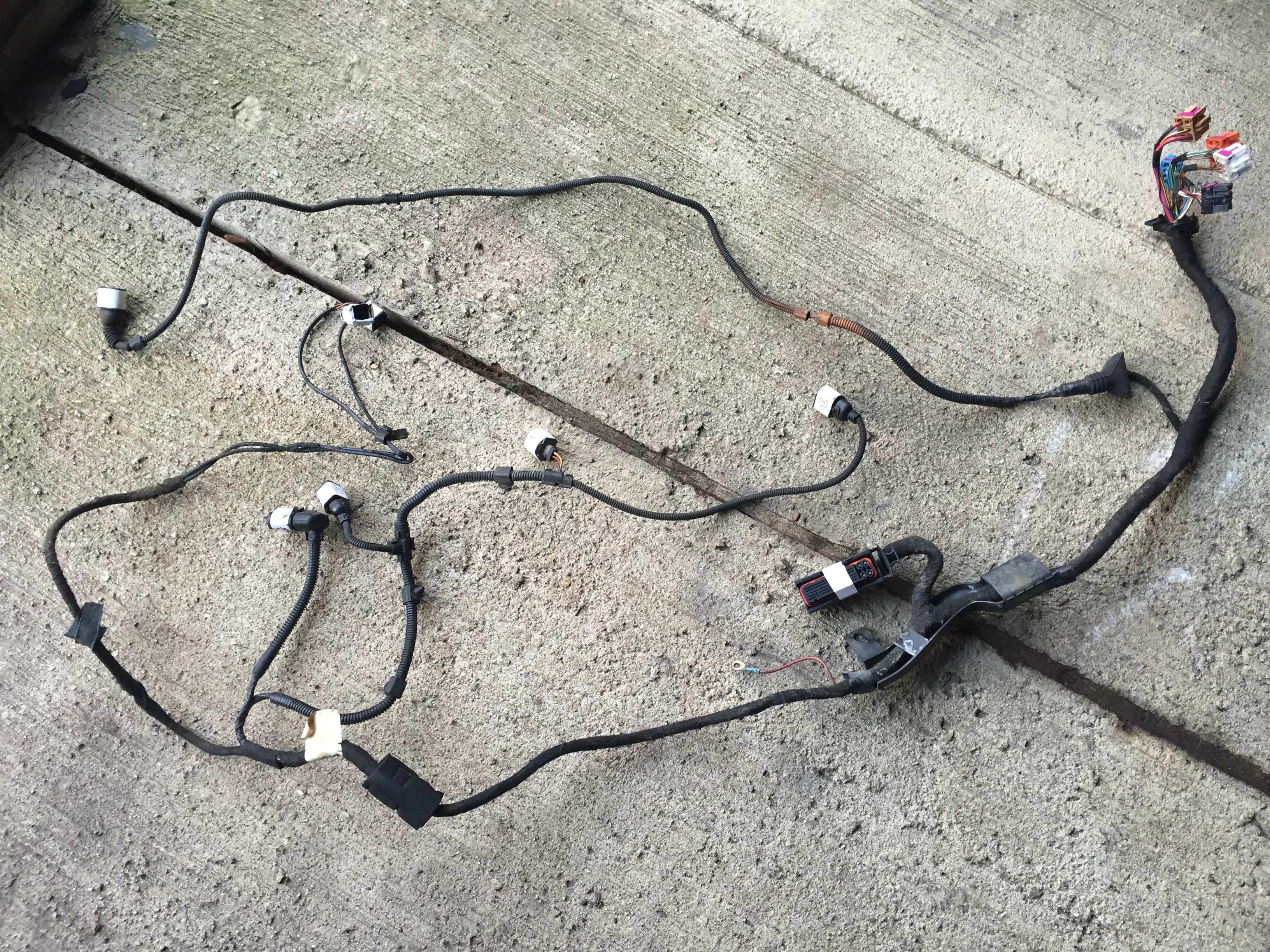

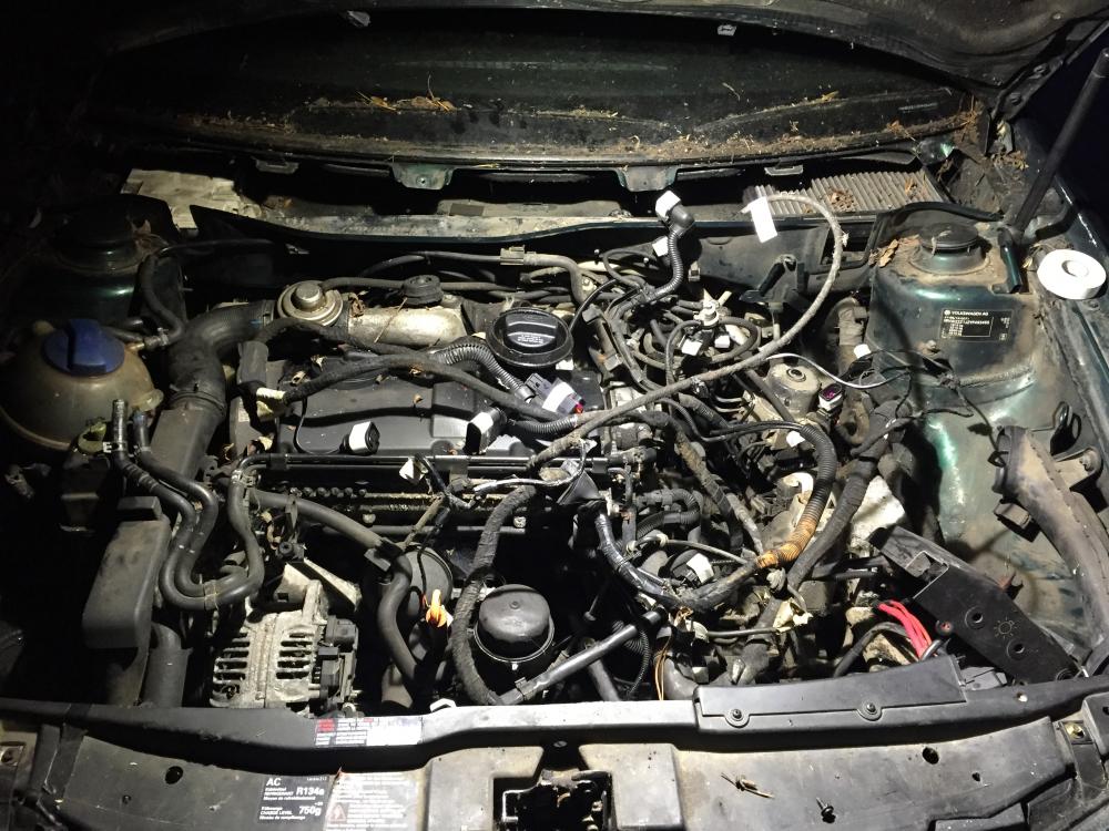

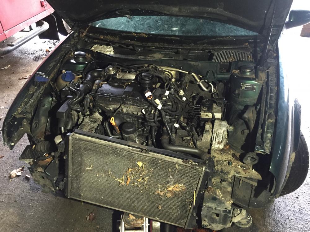

  2. Looking good Bird, looks like a decent base to start off with. Got the loom out of the Golf, amazing how much there is an a fairly low spec old car. Inside and out there are 96 plugs labelled and recorded, and even the some of them are doubled up (radio, climate control etc): Then pulled the front bumper off, and got the air con rad, and coolant radiator ready to come off: Then hooked up the engine crane once the exhaust and driveshafts etc were disconnected: Then pulled the engine out: Now I have everything I need from the car, so it can go off to be weighed in. The engine and box need a damn good clean, they're rank!
  3. I think I can, but there are slight differences between the two (fuel pump relay/ battery fuse/clocks/ABS-clocks intergration etc). I am going to completely strip the loom from the Golf so I can transplant anything I need to from one to another. I'd rather spend a few hours now labelling it up just in case I do need to chop and change anything.

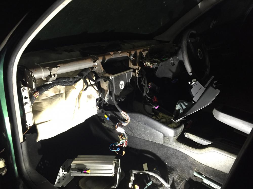

  5. Got my insurance for under £400 (£398.50!) for the first time. Not bad for a £12k car with declared modifications, so pretty chuffed with that, it's always hovered around £500-£600, so when they said "What's the best offer so far?" I thought I'd go in low and say £400, which they obviously beat...wish I'd gone lower now! In actual car news, the PD TT work has begun. I've started stripping and labelling the wiring looms...doesn't look or sound like much (there's 30 connectors identified and recorded), but there's several hours work here! Hoping to get the majority of the wiring out at the weekend, just need to take the dash etc off to get to the bulk of the loom. A friend is lending me a de-pinning tool, so I won't have to improvise with bent-to-shape paper clips anymore lol! Then once I have the TT I have to do the exact same, then swap them over.
