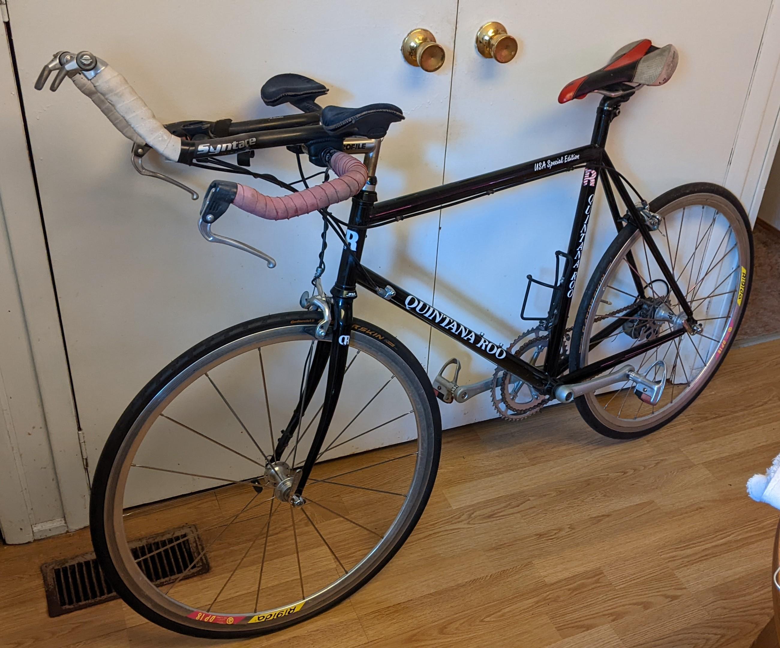

  21. Picked up this beauty for $120. Not reason why, just thought it was cool and will give me something to tinker with this summer. I feel like it's gonna be fast.
