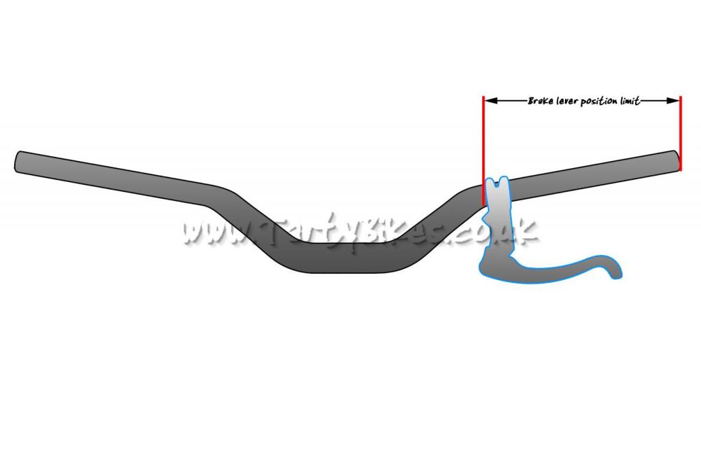

Canyon / SQlab 30X trial handlebar - brake lever distance.
Szymon replied to Szymon's topic in Trials Chat
195mm- 1 reply
- 1
Canyon owners - Can someone measure the maximum distance of the lever from the end of the handlebar? Unfortunately, I'm looking for a handlebar with a longer length than the Inspired handlebar.
