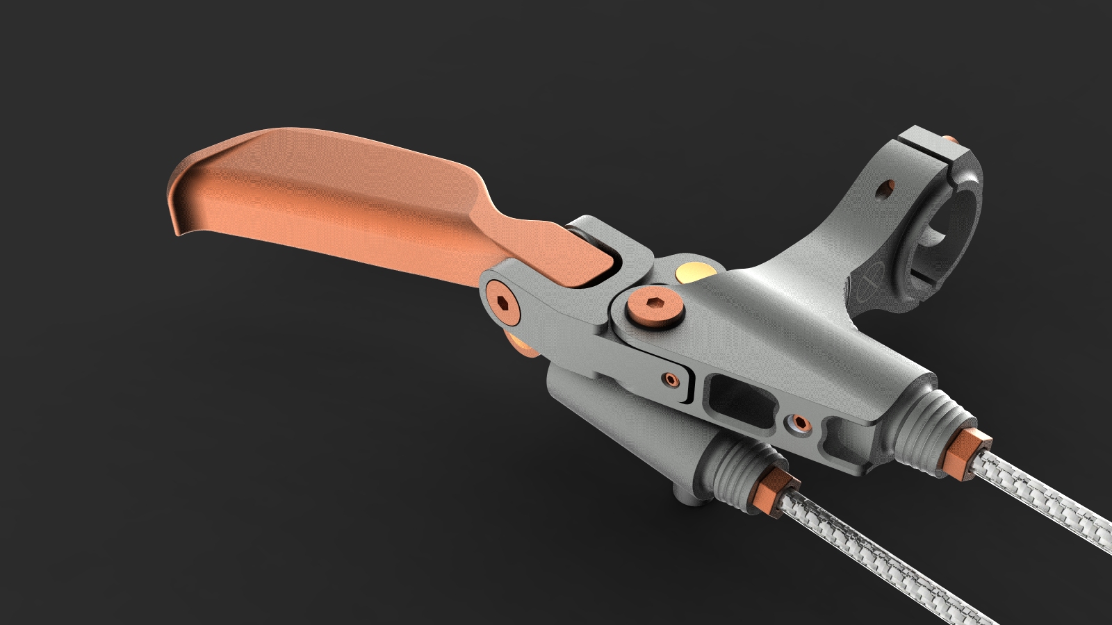

	Reach adjustment isn't about how far the pads are actuated, its about how far away the lever blade is from the bar. The X-Flow has a reach adjust of 15mm for tiny girls hands up to massive man paws. It also has a pad travel adjust screw (does same job as TPA on Maguras) so you can change the pad travel distance of each brake separately, without affecting the reach. Don't worry, its all in there, I know my stuff. Its not patentable unfortunately as I used focus groups and medical practitioners from day one so it was technically 'public' before it even existed. I do however have a design registration on the extended lever blade surface. The actual prototype (£1475) is right side specific but you only need to change the shaped lever blade.. every other part is ambidextrous. Anyway, Luke would only break it!! It's a been tested by an XC rider with minor paralysis in his left arm and he loves it, even offered to buy the prototype off me. http://olisparrow.co.uk/HTML/Xflow.html as I have already posted about 8 replies ago... bit of reading goes a long way. Oli
	Well, linked to the ideas of the book that Psycholist mentioned (below) the whole thing was designed taking into consideration the tactic aspects of regular brakes. This is as close as I could get to the absolute normal operation but keeping the functionality I wanted. I rode it half way across london then for the photo shoot you can see on my website. Its almost second nature within minutes. You do lose a degree of control for the secondary brake but you just need to slightly adapt your riding style and carefully consider what movement operates which brake when you're setting it up. It was of course designed specifically for people with certain disabilities and at the end of the day compromises have to made. It is also there to cater to the widest selection of bike riders, which would be more oriented toward XC or general transport/leisure use. That book is great and Donal Norman is a bit of a legend when it comes to putting successful design in its place however you can't take everything he says too literally. I've really adopted his idea of the Visceral, Behavioural and Reflective levels of design, I used that a lot with this project. Thanks again for all the comments and as I said, come along to the cycle show and try it out for yourselves. Oli It is for whatever you want to use it for.. although my prototype is specifically designed for magura use. I'm a designer.. marketing comes up with the names haha. At least it actually means something as when you pull the lever, the two hydraulic column's flow direction crosses. It's also meant to latch onto the common terms used in mountain biking i.e. Cross-Country becomes X-Country or XC. You're meant to read it as Cross Flow whereas there are a few motorsport products called XFlow that just have an X in there for the hell of it. Cheers for the complement.. I do my best, make sure you do too ho bag. Oli

	- The extended top surface of the lever blade makes it act exactly as existing blades in the secondary braking plane. If you have the lever set at the correct angle of 45 degrees to vertical the action of pushing the brake down is almost the same + you actually have more modulation. You'll just have to trust me and my tester on that one. - There is indeed a chance of pulling the wrong brake. If you run two levers on one side or if you ride an american bike there is exactly the same danger. Its called adaptation! + The user originally defines which brake is which upon installation. - Congenital limb deficiencies, amputees (plenty of handlebar attachments on the market for arm amputees) Rheumatoid Arthritis, Carpal Tunnel Syndrome, Muscle Wastage due to vitamin deficiencies etc. Also, some people might just prefer to only have their controls on one side... everyone's different but constrained by the same products. There are also a shit load of people that convert bikes into mopeds and have to give up a brake or bodge a double lever due to the clutch. - The third and fourth fingers used for pulling or crushing operations can cause massive physiological damage over long periods of time, remember road cyclists use the levers at different angles and not half as much os other cycling disciplines. Also if you're using all four fingers to pull both brakes simultaneously, then you havn't got a good enough grip of the bar for balancing on a wall, riding over bumpy XC trails, flying down a hill on a 40lbs bike. You may be right but my testers, Occupational Therapy, manufacturers and the people that have already ordered one tell me otherwise. I'm not saying its a perfect product. I know where and what all the flaws are and I'm discovering new ones all the time however, its my degree project and I'm working to a brief... for a grade.. so thats whats important at the end of the day. Oli

	Two separate cylinders.. The easiest way to think of it is two completely individual brakes in one unit.. one of them perpendicular to normal. There is almost no situation where you would need both brakes on at the same time for competitive riding. Also, having one piston operating both brakes would require that the distance between the pad and rim be exactly equal otherwise one would bite at a point, then the lever would continue to travel until the other did, then they would both be capable of locking. Individual control is paramount for on cycling activity. Correct and correct Yes, very easily. And easily modulate between the two during use. Cheers Oli

	Hi, Thanks for all the discussion and comments. Its been really helpful so far. I'll try to answer all the questions so far: The leverage for the 'weak' brake (the one you push down) gives a mechanical advantage of 6.5 .. roughly the same as that of a regualr HS33. So the strong brakle has MORE leverage rather than the weak brake having less. Matt Rushton... It would make it exactly the same as two conventional brakes with only your own physiological operation changing the braking power. Luke Rainbird... All I can say is, it works. I have experimental rigs and a SLM prototype to prove it. PaRtz... Pretty much spot on with all of that. At the end of the day, the pushing down force is amplified by a factor 6.5 creating 128 lbs/in^2 on the rim... 12 less than a conventional magura (at the strength I pull it with anyways) Jamie_Neal... It has the same set up as hope and shimano disc levers where the pad travel is adjusted by a 2mm allen key.. no TPA im afraid. (Too many patents!!!) Finally, a general point: It is primarily a disability product and so some loss of braking power over existing systems is to be expected (although not very much in my case) It has been designed so that you may choose which motion operates which brake so that it can be used cross-discipline. I've sorted out legal issues with my manufacturer so I'm not 100% free to discuss everything if you needed to know more. Oli

	This particular model is suited for HS33 (14 mm diameter cylinder) Piston stroke up to 20mm, optimal at 12mm. The concept itself can work equally well for Rim brakes, discs and even cable pull.. I just havnt bothered with any others yet (you can clearly see that there's a lack of reservoir) The product also uses a number of existing magura specific components negating the need to product more and it is suitable for retro-fitting to HS33, echo, etc. calipers. Keep the questions coming.. helps me see if I've got everything covered! Oli

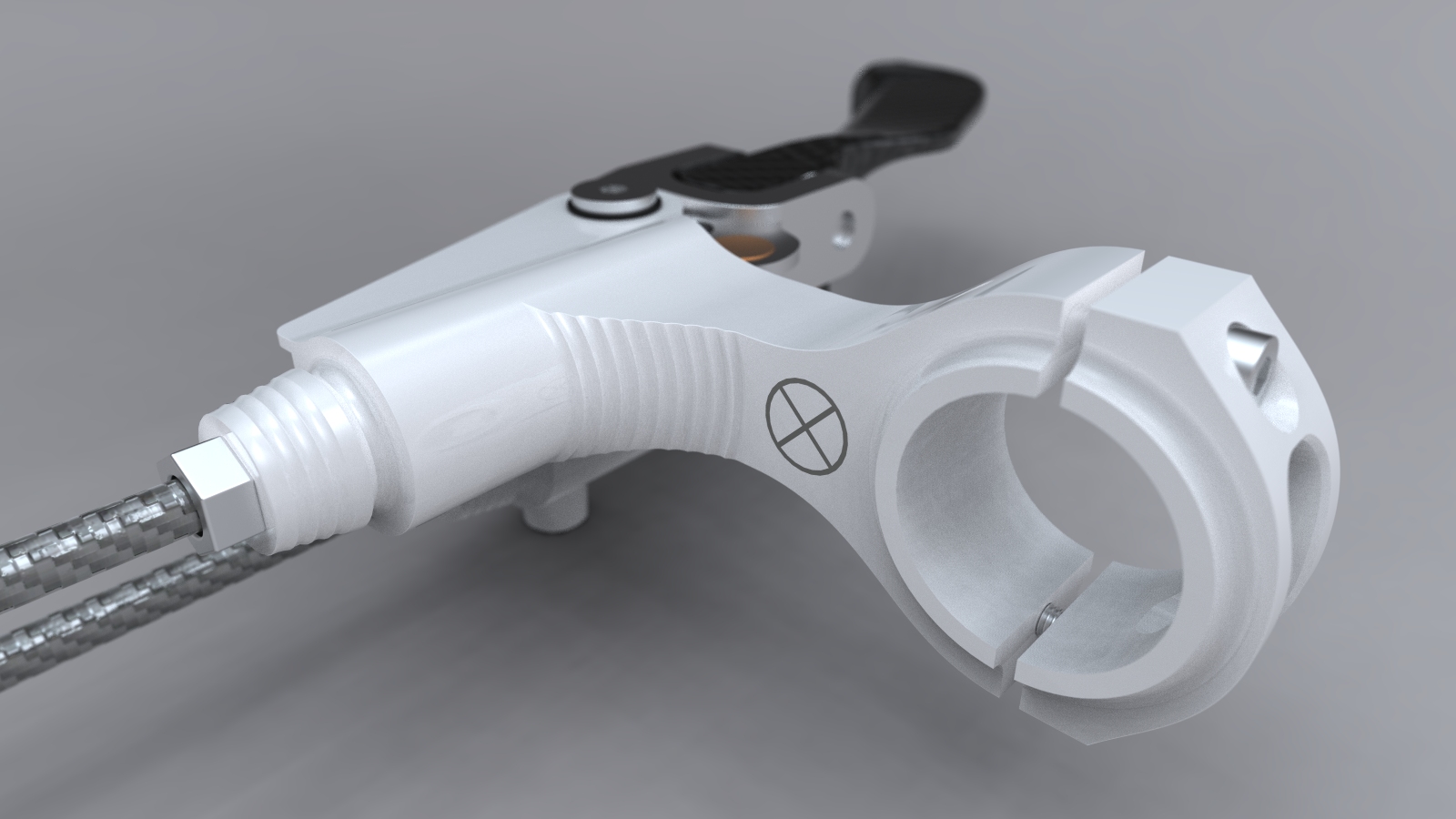

	Operation of both brakes from one lever on one side of the bars. (Primarily designed for the disability market) Oli
	Hi all, I posted up a few months ago asking for a bit of input on my project.. thanks to the 1 person that replied! Better than none! Here's another chance.. The project is getting pretty close to being finished and I have a few images of the lever unit as it is at the moment. Please, any comments or criticisms are welcome from everyone regardless of age, background, sexual preference etc. at the end of the, its people like you guys that it would have to sell to. Unfortunately I'm in negotiations with an undisclosed manufacturer so I can't actually legally tell you how it works, but if you figure it out for yourself thats fine. Just let me know what you think of the overall look of it.. imagine the colours and surface finishes exactly as you would have them as these have not yet been finalised. (Yes I know it looks a bit HOPEish but thats half the point of the project.. again.. not really allowed to explain) Cheers Oli
