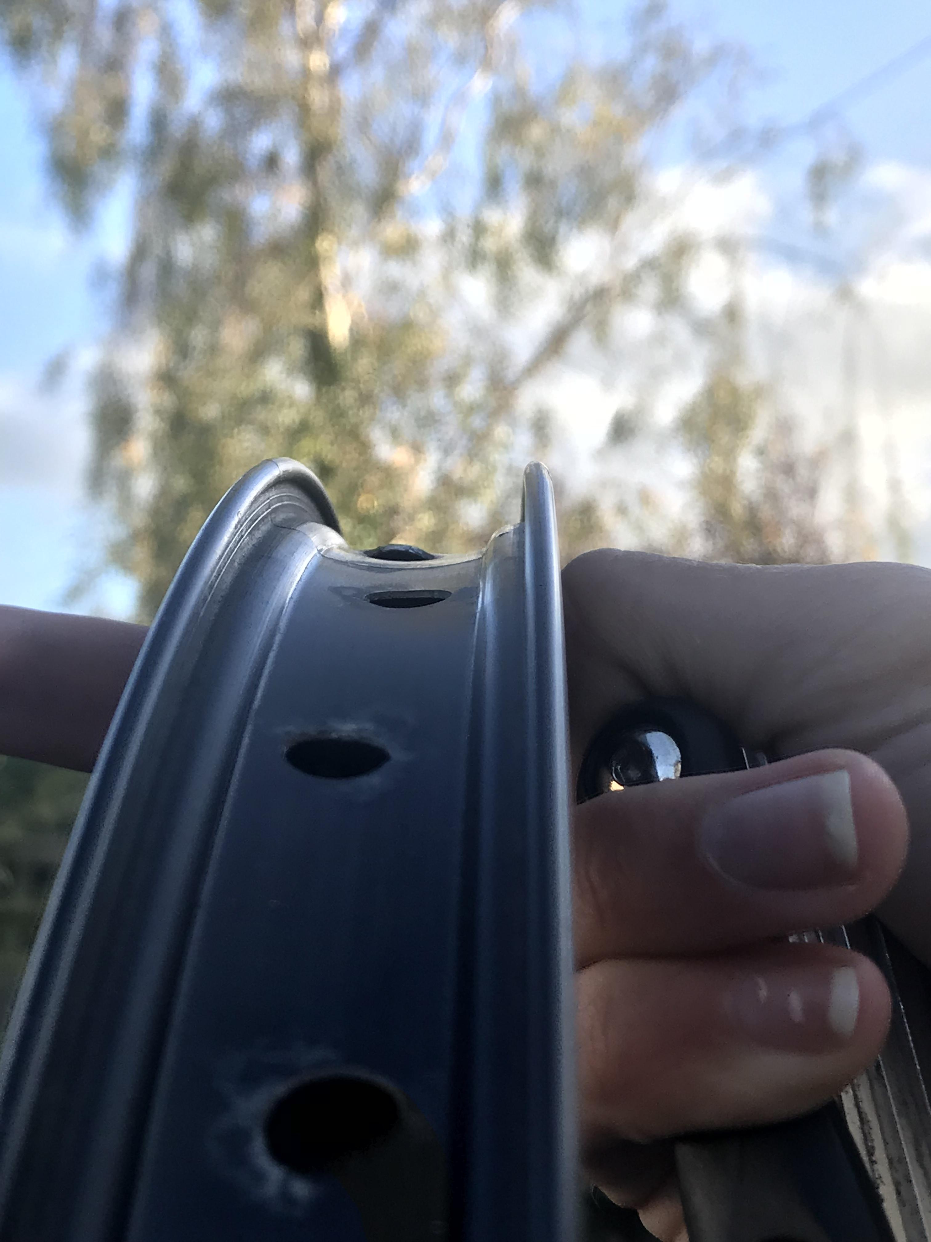

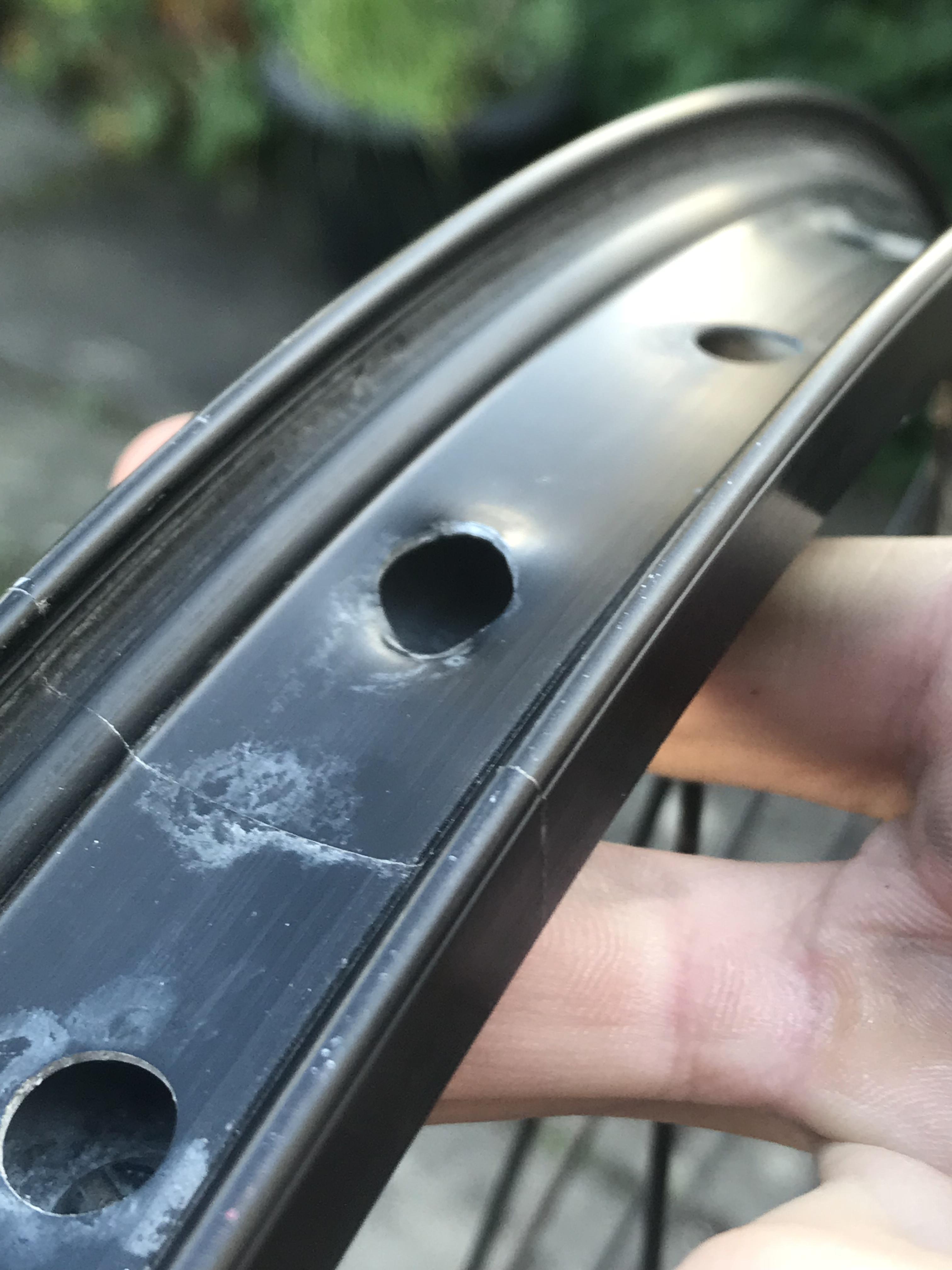

Been getting quite a few punctures recently and wanted to check the rim. Noticed that one of the spoke holes isn’t the way it should be and I was just wondering what would have caused this? I’ve wrapped some extra rim tape arround in case that was what was causing the punctures so hopefully no more for a while

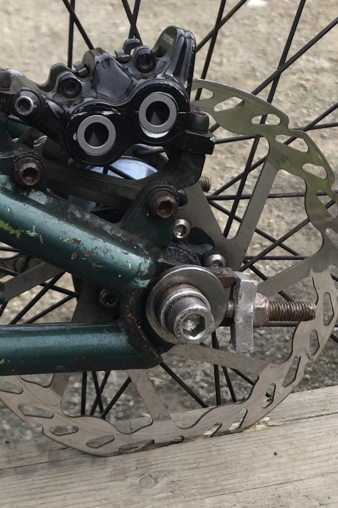

I would definitely agree about there being an issue with pad clearance (although it wouldn’t be if I was better at sidehops) They have some pretty impressive stopping power although the lever feel took a few rides to get fully used to. The lever may be metal but there is still a slight amount of flex in the lever body. Picture attached is an example of my questionable sidehop technique.
Thanks for the tips! I’ve managed to get the first one out. It was sitting very slightly proud of the hub, but not enough to grip with mole grips/pliers. I used a very small chisel and a hammer and managed to slowly tap it round enough so that I could get the mole grips to grab it. will most certainly need to drill the other one out as it is sheared near the bottom of the hole.
About to go for a ride and noticed the rear rotor was really loose. Turns out that two of them have sheared halfway down meaning I can’t unscrew them. Whats the best way to try getting them out?

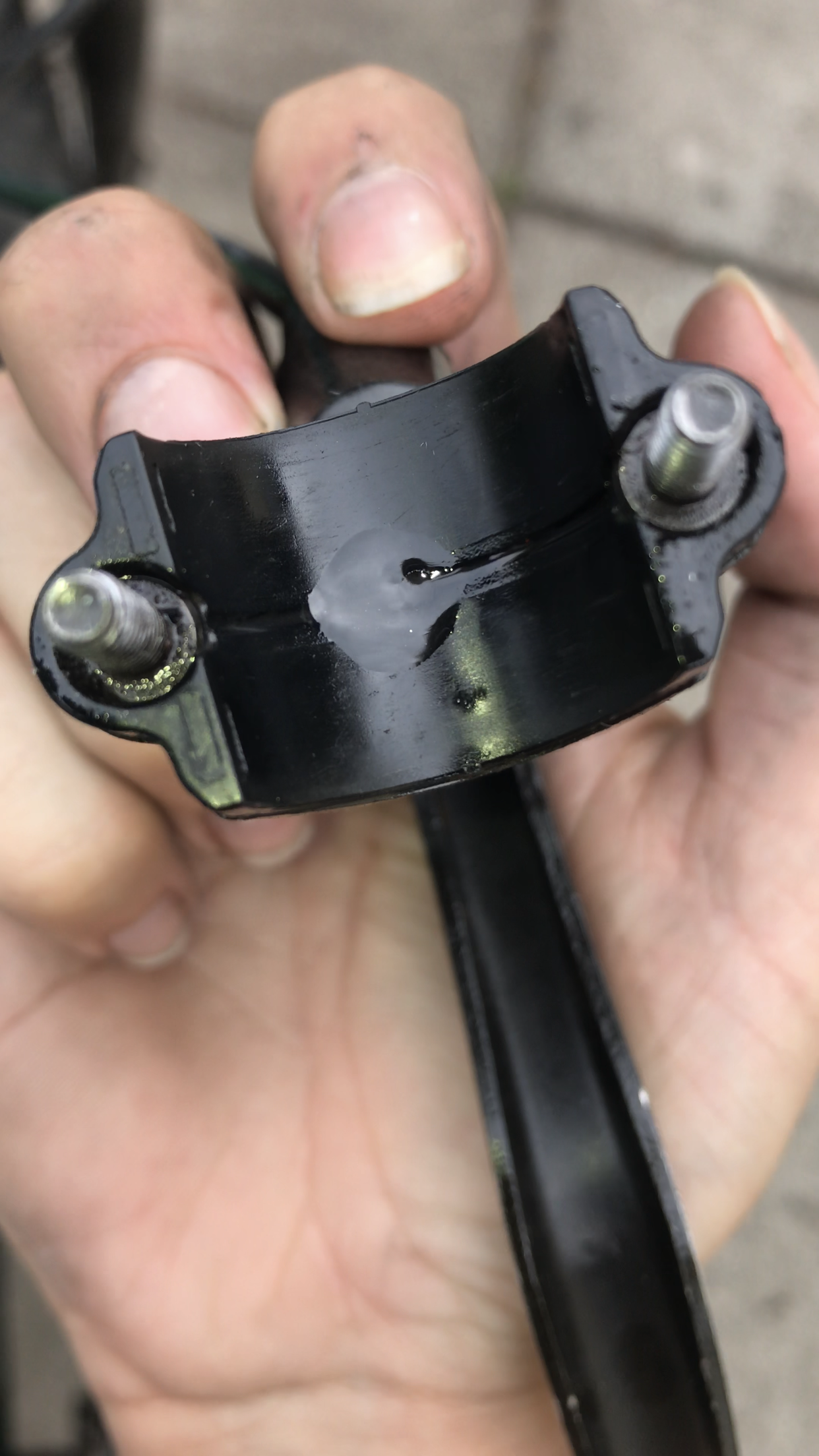

Found out what the issue was today whilst trying to bleed it again. It appears that the lever body has a leak Is it worth contacting Maugura even though I purchased this second hand? And does anyone have any temporary fixes that might work until a new brake arrives?
