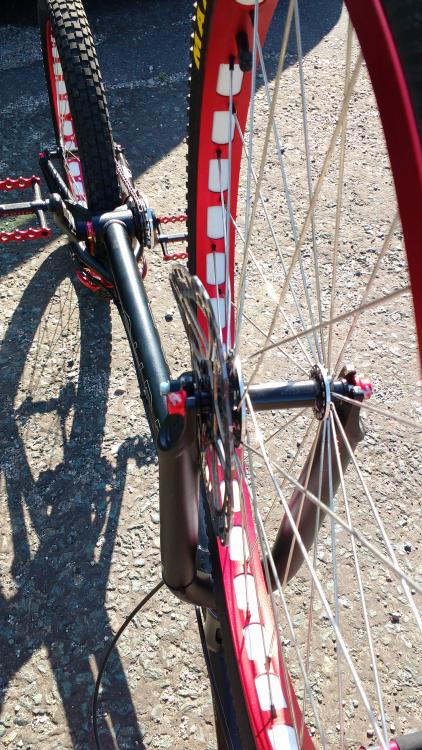

  8. Daviesdt
    Oops!
    Yeah, pretty sure it's not supposed to look like that... Any tips for straightening a bent rotor? Or should I give up now and buy a new one!?
