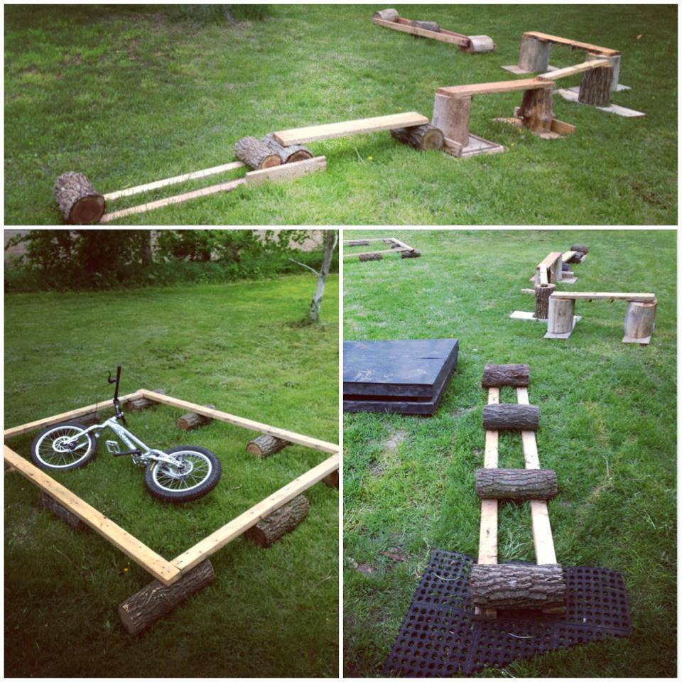

Plan to build similar features to have in the yard. Initially I won't add the log hopping stuff. Also, asked a friend about large diameter wire spools. He beleives that it may be possible to get some in the 4 foot diameter size. PK
