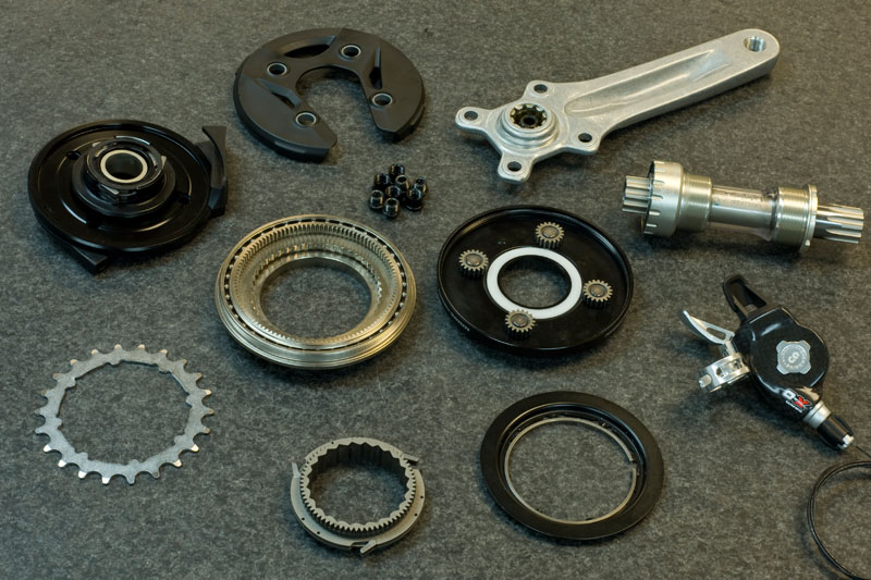

  6. Christ, whats this? Is this something i want to own? Truvativ HammerSchmidt
  7. You sure? sounds to easy, i actually have a pair of older red race face cranks laying around in my workshop, not sure if they are isis but i sure hope so According to tartybikes there was no solution, i dont really expect any isis to work, i found that the hollowtech came With a longer axle, theese sram cranks i have are specified to work With a 89.5mm wide botton bracket, frame is 68mm. i dont know, maybe what im doing is stupid, but i am at least trying bike is in parts anyways Thanks
  8. yes 24mm, its a echo style Spanish bb yes. the inner Dimension of the bearings that came With frame dont work. i have ordered some 24x37x7mm bearings, when i get them i will do a final measure to make spacers. I have the 128mm wide isis bb, according to admin @ tartybikes, this was the widest bb he knew about and could only recommend me using Maximum 18t, so im experimenting. will probarly just ruin everything but i want to try. its the two speed sram cranks You know about any isis crank to fit my purpose? Thanks
  9. Ok, its a because simple street, the sram crank is wide enoug to fit the frame, i have opened a gpx bb to extract the bearing. the bearing inner size is different on the two bearings, One goes over the axle and other one does not, the other only goes over the first part and that bearings inner size is the same as the bearings tha comes With the isis bb. I need one ore two bearings that goes over the axle and two 1cm wide spacers, i can make the spacers but dont know where to find the bearings so im stuck. maybe buy another gpx bb but so expencive 80 pounds local

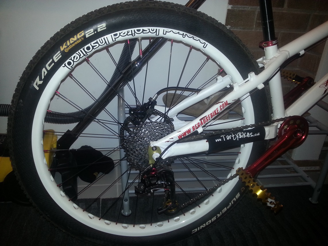

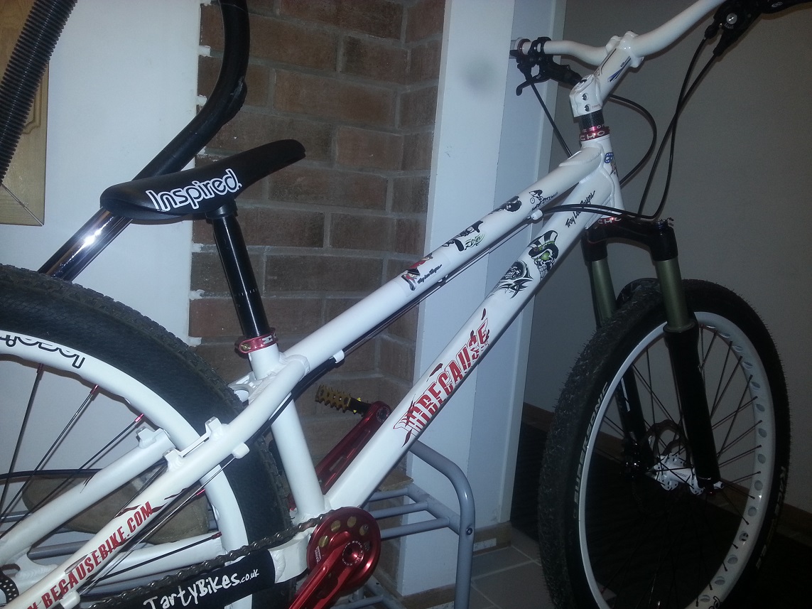

  10. Hi guys, i just lost my drivers licence, so i have been trying to build a trial bike to get from A to B. i have put sram xo rear derailleur, cassette and shifter on it so far, but the cranks i cant get to fit I have sram cranks, the ones With widest axle to try build something, but im stuck With the bearings and making some desent spacers for it. il post Picture if i manage to make this New thread.
