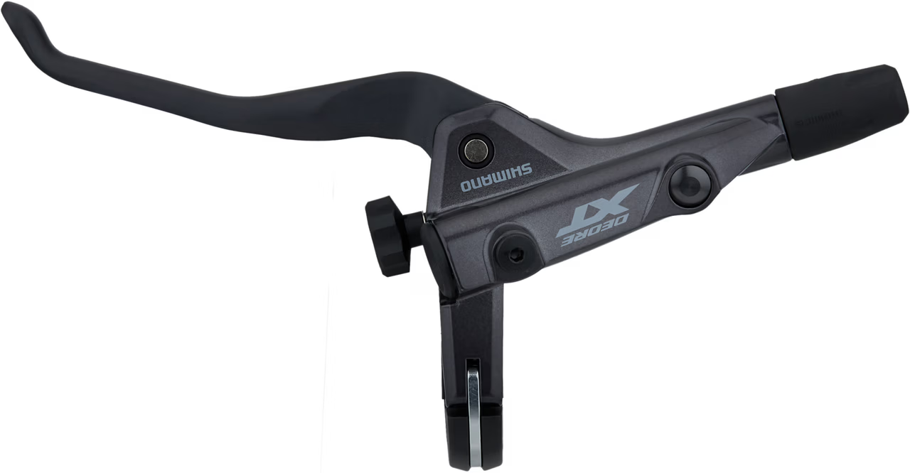

  13. That helps, a lot. THANK YOU! So your effective stack should be slightly above 710 mm. With this abomination https://www.ergotec.de/en/products/vorbauten/sub/ahead-vorbau/produkt/high-charisma-31-8.html, I have 720 mm, but I can lower to 710. Feels a lot better than the 680 I previously had.
