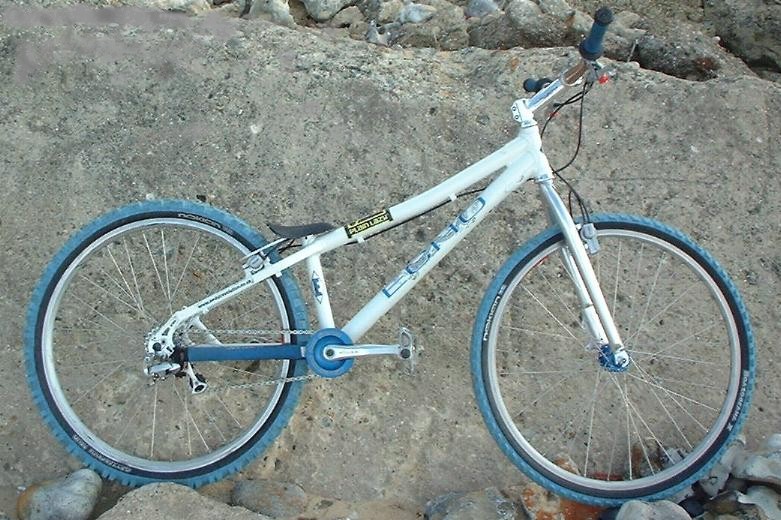

  23. Oh my - That was you ! I remember thinking how beautiful that was when you posted it aeons ago , Christ do you have good taste in bikes ! Testimony to the longevity of Kings too that one has survived trials usage all these years intact . Now to whom did this : ...piece of awesomeness belong ?
