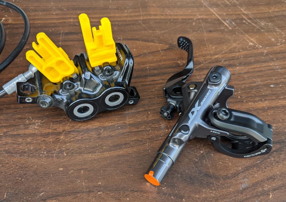

I used an XT lever in my experiment. It worked perfectly and they're easy to bleed, but I eventually went back to MT5 levers.

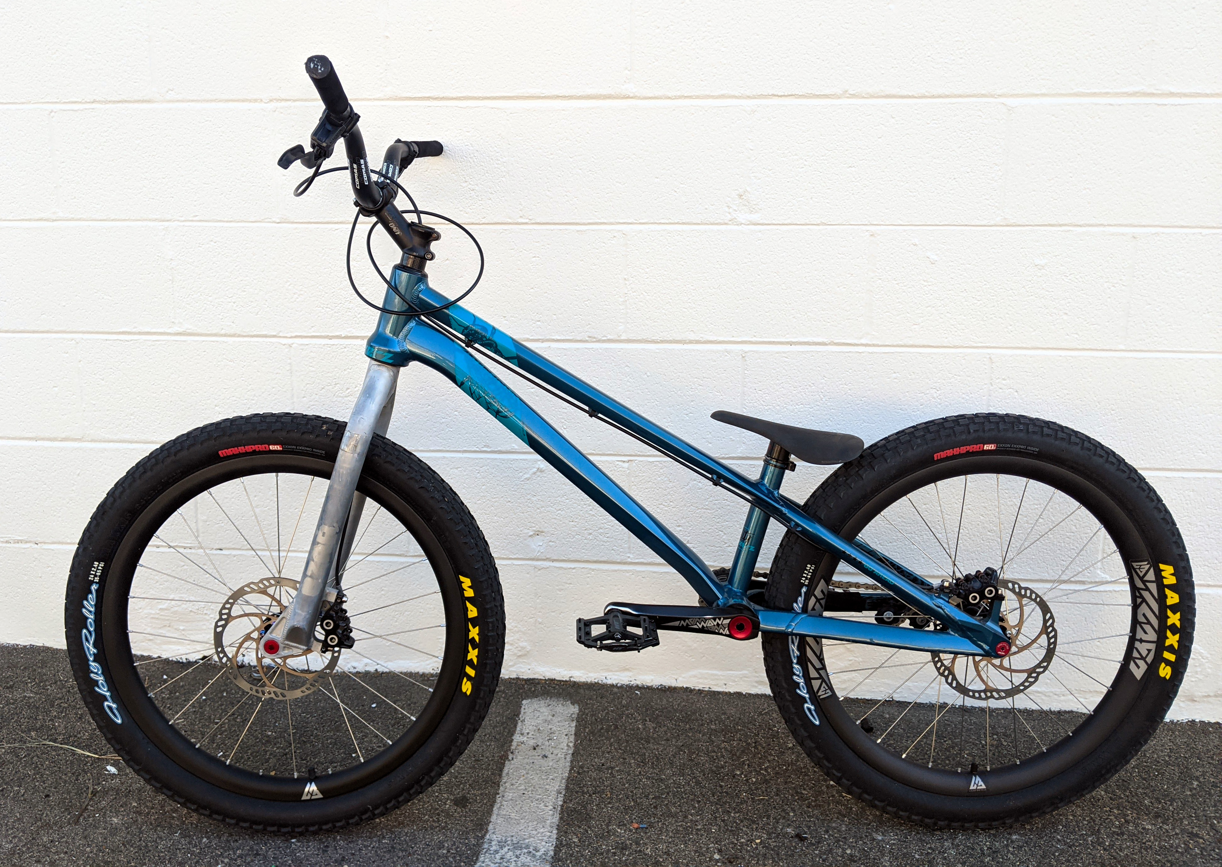

Update: So I finally broke down and got the WAW cranks that are made for this bike. The Bonz were working ok, but the 46mm press fit BB to 24mm axle just introduced too much flex in the system even though I was using Rotor's BB that is 46 to 24 without adapters. The WAW cranks are admittedly pretty sweet. Oh well, lesson learned. Also finally got carbon rims for this baby. The front is a 30mm BMX 24 and the rear is 38mm. They're both from Light Bicycle. I've only gotten 2 rides on them so far, but great so far. The wider rear seems to help the Holy Rollers fold less on sketchy landings, but I haven't gone bellow 35 psi yet. I'll keep you posted on these hoops. The bike is down to 20.2 lbs/ 9.16kg ;-)

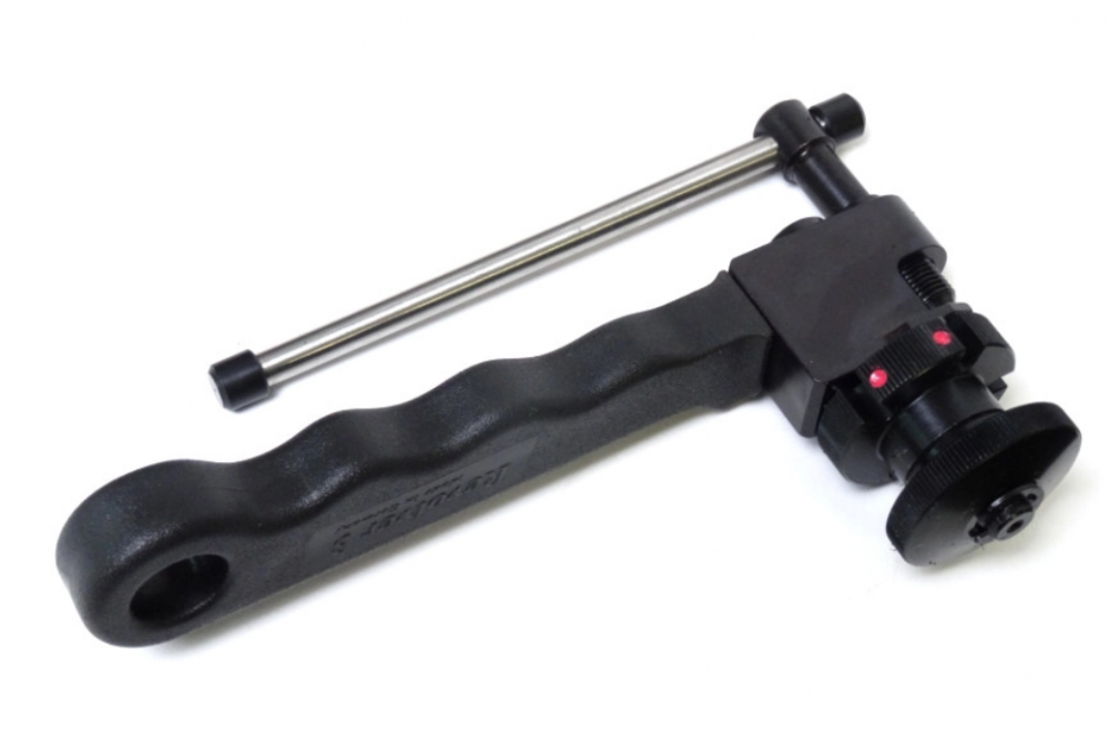

I was appalled to find a quick link on my Hex too. I got rid of it pronto! The pinch bolt is highlighted in the photo below. It's underneath the bike, but not one of the 2 bolts that hold the plastic tensioner part to the chainstay. If you want the absolute best chain tool available, get yourself a Rohloff Revolver 3 tool. It has the ability to re-rivet the chain pins for the best security possible, but it's pricey. Another trick for the tensioner is to put 10t jockey wheels on instead of the 11t that come on it so you can drop a link and/or straighten the chain a little bit more.
