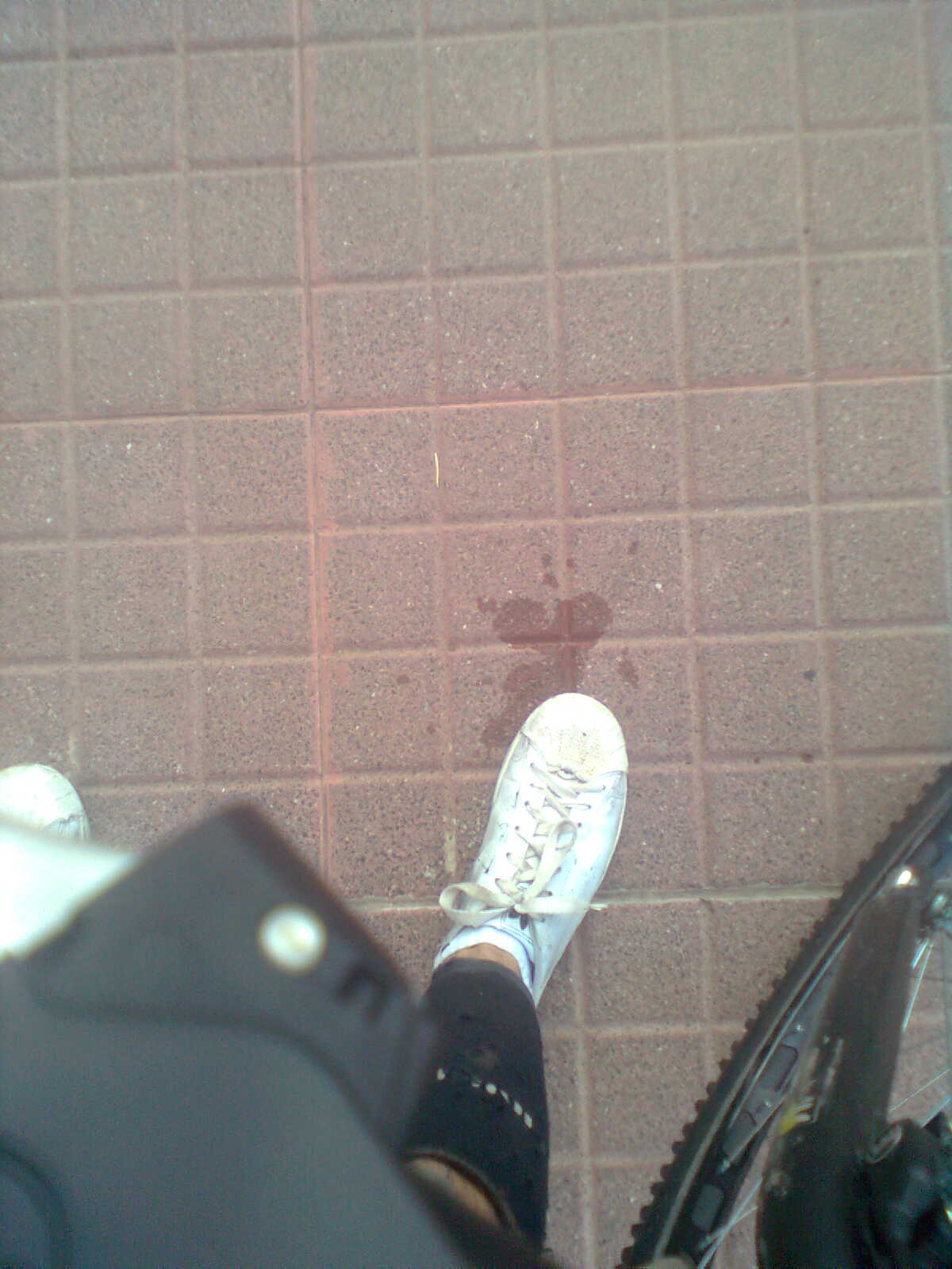

  8. Sent it from the TartyBikes' webpage. Will re-send the email if you want. When it was bleed with oil it was also leaking, I remember the rear brake was oily even when I was using it before shortening the hoses. What would you like me to do for you to see that the brake is actually leaking? I took the photos with my cellphone, sorry for the bad quality. I would hate to re-bleed the brake only to see it leaking again and need to switch back to the other lever, but if there is no other option I'll do it of course. I've used the rear lever in the front brake twice and it leaked both times. However, the real front lever has never leaked, so it's not a barbed-fitting problem. Juan Manuel

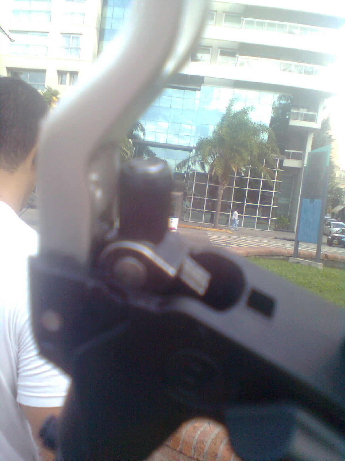

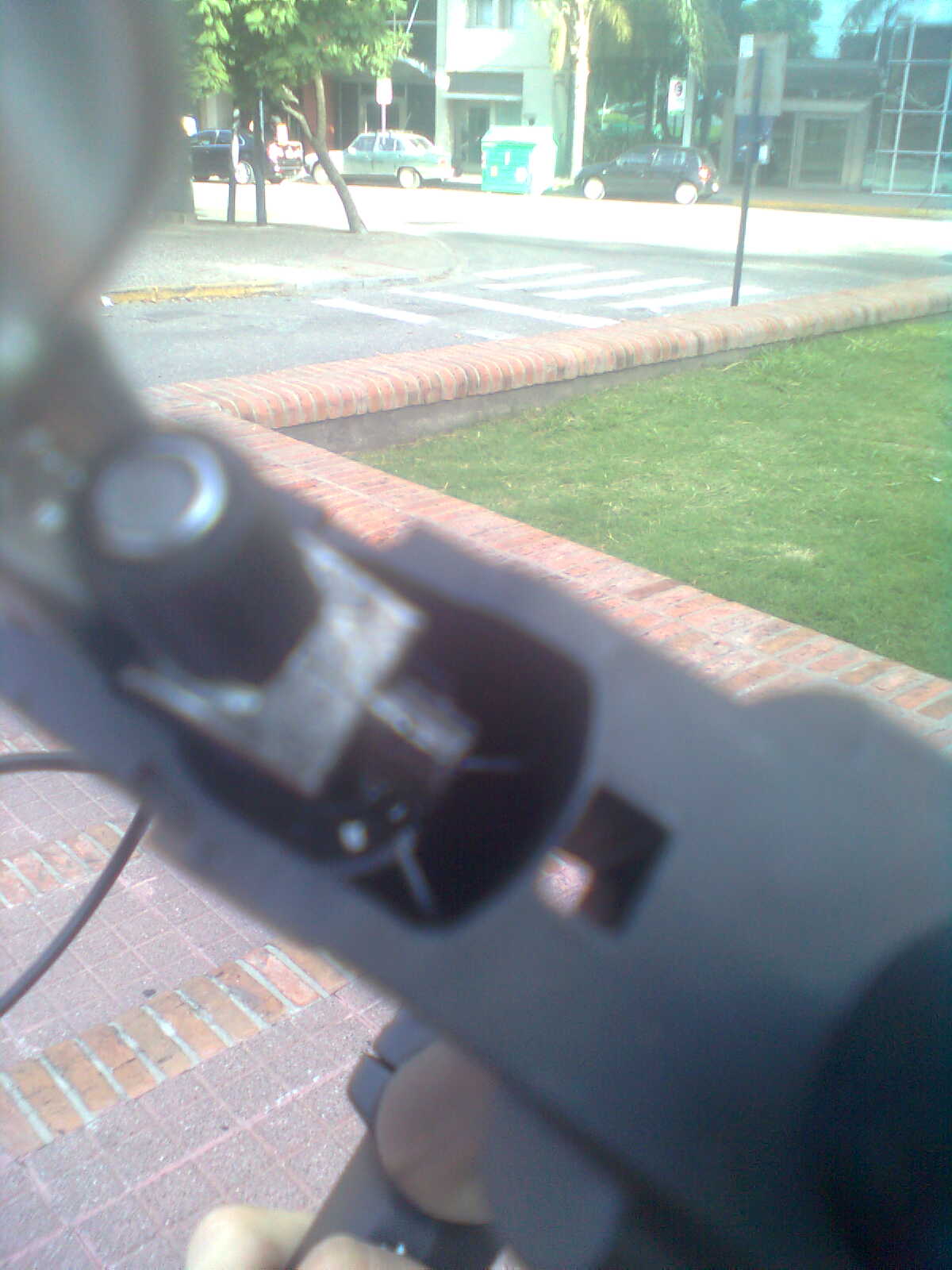

  12. Well, today I did bath bleed the brake, took everything apart and resembled the brake under the water (obviously i didn't disassemble the lever nor the slave cylinders) bleeding everything separated. Rode my bike (today is not raining anymore) and in 1 minute the water escaped (another few hours lost). The brake IS leaking and through the PISTON/CYLINDER. How the brake ended up after loosing the water: Please help to claim the guaranty, I don't know how. I have a comp in two months and would also like to train for it. Juan Manuel

  14. Tried the bike today. Was raining which didn't help me to see where was leaking from but the barbed fitting is perfect and was assembled correctly. I started using the brake normally until the lever eventually started reaching the handlebar, the water is still escaping. This brakes are driving me crazy Will try to post a video or something.

  19. Hello, I bought a pair of new Magura HS11 at TartyBikes. I had to shorten hoses so then I had to re-bleed them. They were of course difficult to bleed, not only because they were different from the previous ones but also because they don't have threads in the lever to connect a syringe (so you always have to bleed the entire brake from the slave cylinder), and you have to undo the lever nut until you see some threads, and the Bleed Port plug is hard to take out besides it's small and can easily become lost. After the bleed I pulled the brake 4 or five times with only one finger and with the strength required for some techniques (I'm 16, have rode trials for 3 years now and I perfectly know which strength should the brake be pulled with)and the water (I did a water bleed) dropped off to the floor. Tried using different TPA setups to see if i could solve the problem but it still leaks. Then, I put the old Magura HS33 complete lever I did re-bleed the system and it worked perfectly fine without leaking. My HSS11 2011 lever leaks. Does somebody had the same problem? Ways to solve it? (I hate to bleed the brake with oil but it may be a solution, still don't know) HS33 levers are in some way better? (I bought HS11 because I red in this forum it was essentially the same thing) If the solution is replacing the levers, which levers should I buy? Thanks, Juan Manuel
