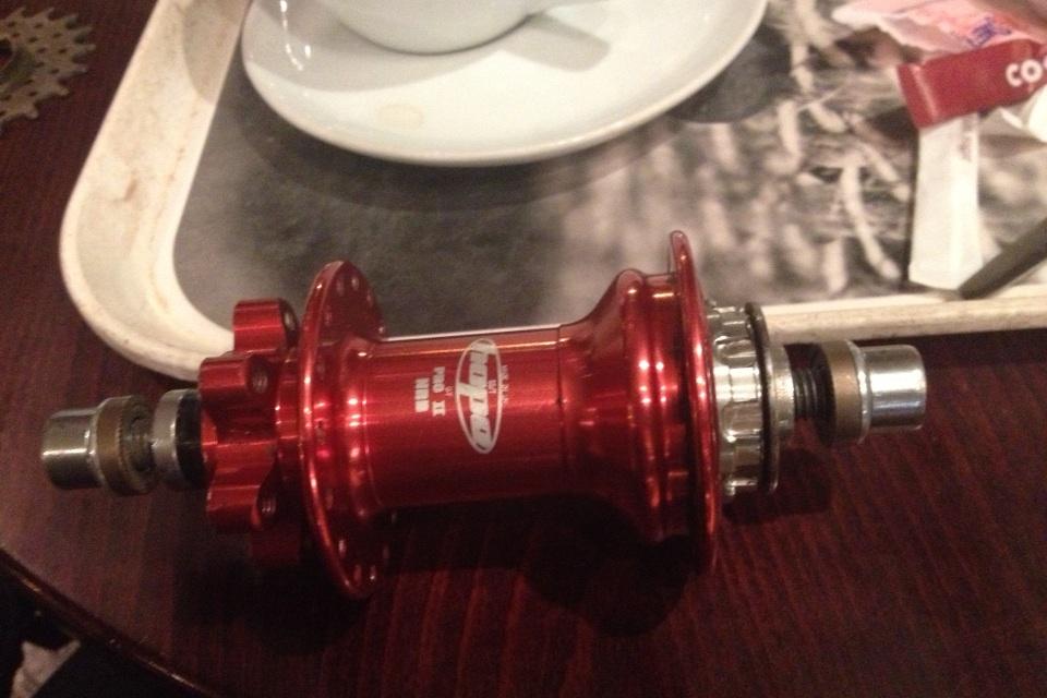

  7. The dishing of it won't effect the strength of the build much at all. Being such a small, wide wheel as it is. But yes, i could have cut down the end cap on the non-drive side a bit, and allow about 5-10mm of extra room. But that would have arisen other problems with the freehub body not being stable with only one set of bearings holding such a wide distance from the shell.
  8. The non drive side is as standard. I have left it like that so you can run a disc if you so wanted to otherwise, whats the point ay?
  9. Love it! I can most likely modify one if you want it done in the future
  10. You'll be able to run a disc yes, the hub is still fully functional I will have to dish the wheel a lot when building it, but as said above; won't effect the wheel strength. I hope George has a variety of spokes
  11. If anyone knows where I could get trade price parts, I could indeed make a few

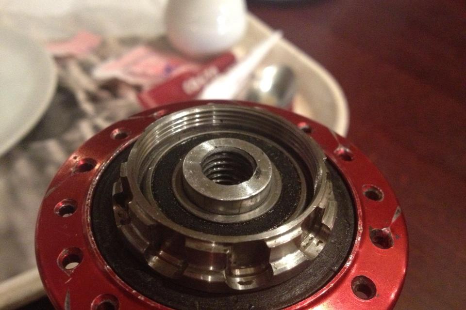

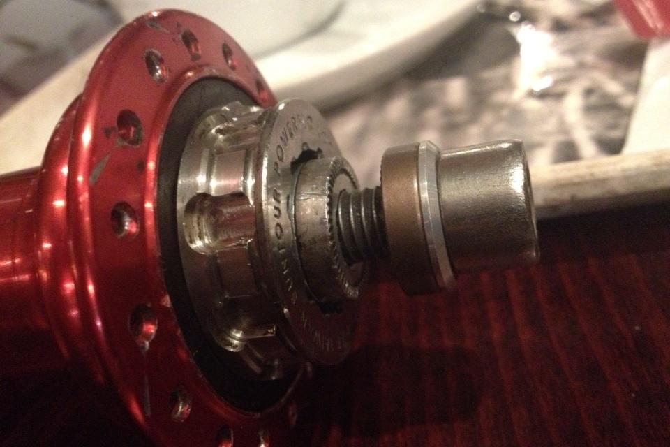

  12. Right, this is the finished product. I've obviously done it differently to Danny, as I don't have a huge spacer next to it I am pretty confident it will work, and have clamped it up right to check and all seems well. Time to build the wheel and test it properly I guess. If anyone wants an exploded view of this I shall endeavour to do some pictures tomorrow. I've completely changed the inside of the freehub body.
  13. I've over come the bearing problem, and had to do a lot more to it to get it to compress when you do it up, whilst having room for the lockring. Cutting the thread now, and I've already tested it. - should work.
  14. I have come up with a solution that I think will work. We will see if I am right today when I put it together, fingers crossed it will work!!
