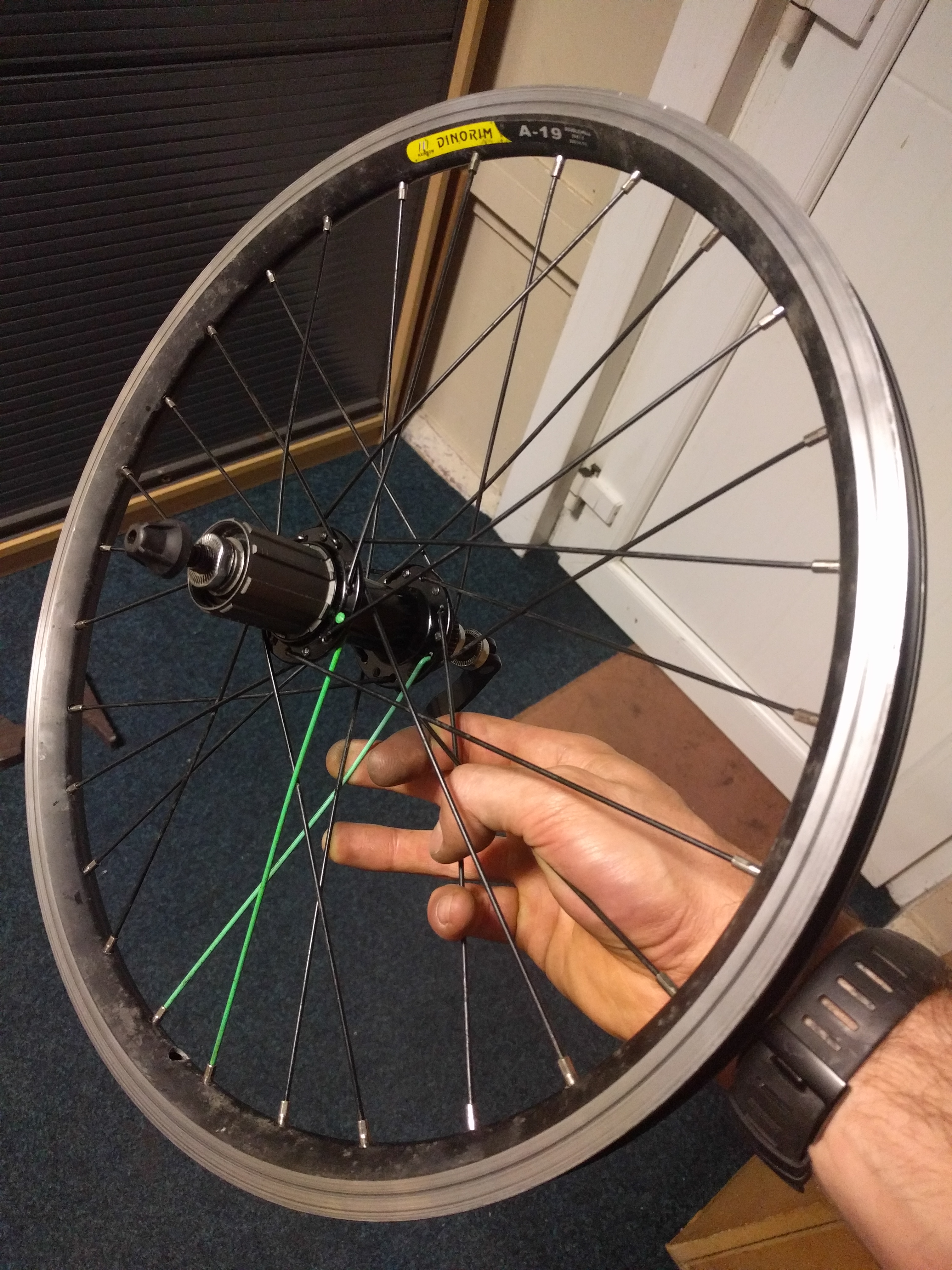

My sons Frog Bike (20" wheeled hybrid thingy) has been in need of a new drivetrain for a while now but it came with a fixed hub and screw on 7 speed cassette freewheel. Had a search about and managed to get hold of a 28h freehub so he could have the old 9 speed Deore gears off his brothers Orbea and I just finished building the wheel up reusing the original rim and spokes! I was expecting to have to order spokes but it's all gone together perfectly, always nice when that happens as now he won't have to go without a bike for a few days!
