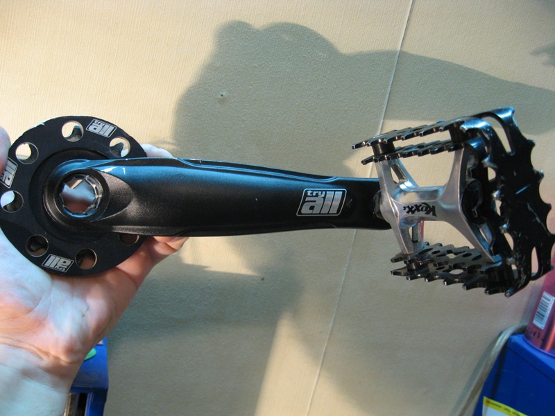

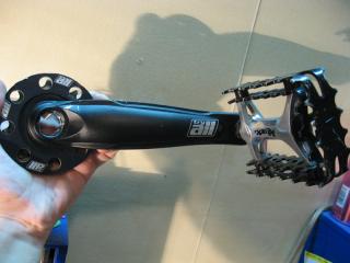

  1. The ISIS cranks come with a front freewheel, frame is koxx levelboss 68mm wide and original tryall BB bearings are on their way to fail, so I am after a cheap replacement untill I receive some proper stuff from abroad. Truvativ apparently has outside bearings but is there enough spindle length to fit cranks? this is the BB (are these even ISIS??): anyone using these?? thanks in advance!

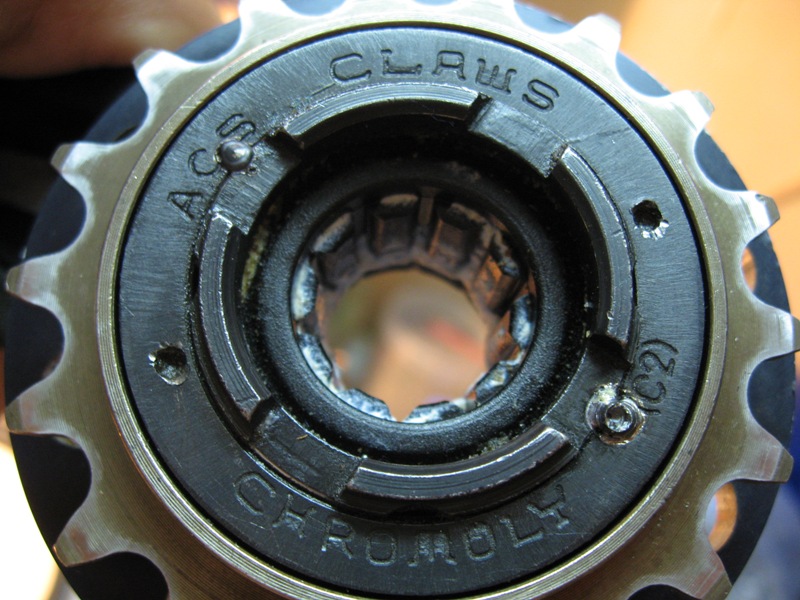

  3. Thanks for the help mate! I fixed it! The lockring did come loose, I took the freewheel apart, put some lube in it put it back together, all those tiny balls, pawls and everything, tack welded the darn lockring thing and now I can hop again life is good again!
  4. I need some help with my freewheel. I recently purchased a used koxx levelboss with mostly try-all parts on it and a ACS freewheel that i rode for maybe 5 hrs or so and after putting to much tension on the chain by taking one link out, it started to get stuck, if you know what I mean. It did not jam completely but it kinda moves hardfer than before. I guess my bearing is damaged. This happened suddenly and after that i did not try to "force it loose" or anything... I just left the bike as it is. I read through some of the stuff here on the forum, and I might be missing something but is there any site you could recommend for some general info on freewheels, dimensions and specs and if anyone attempted to do a "overhaul" of the freewheel, or is that even possible? Tutorials and stuff, you know... I like to do my own repairs if at all possible... Now I know I am going to have to replace it with a new one, but since there are no trials specific stores here in Serbia, I would like to be able to ride my bike while I wait for a new freewheel to get here from abroad, it could be weeks before it gets here. Any help will be greatly appreciated... It crossed my mind I could maybe use a BMX freewheel? Are these even compatible with try-all cranks? Rotation direction? Thread the same? P.S. Sorry if I spelled something wrong, English is not my native language you know..
