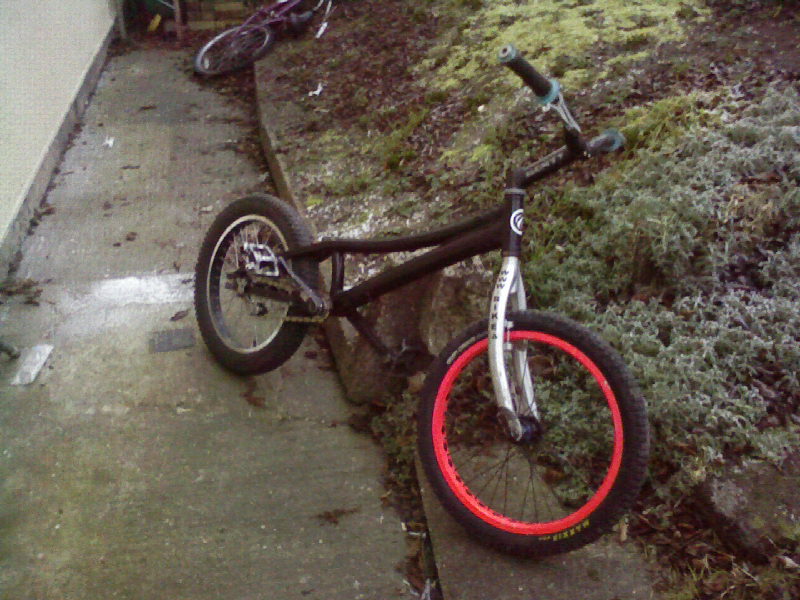

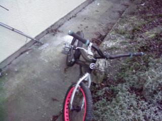

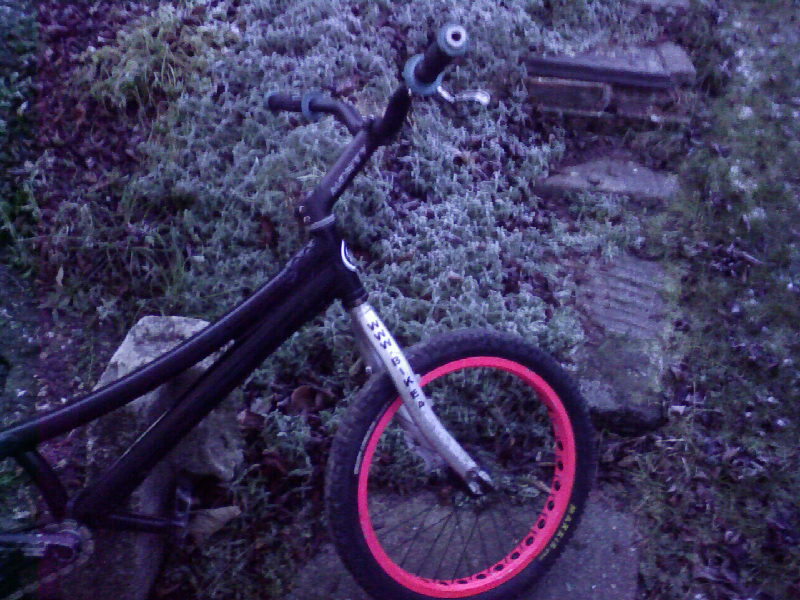

  4. Just a few quick pics, not very good quality as i only had my phone handy ... Also, before any one points out, Yes i am missing brakes.... Spec is: Ciguena frame Echo forks Echo cranks Dicta Fw Monty rear wheel Try-all front Monty bar and stem. Try and enjoy Comments obviously welcome, good and bad

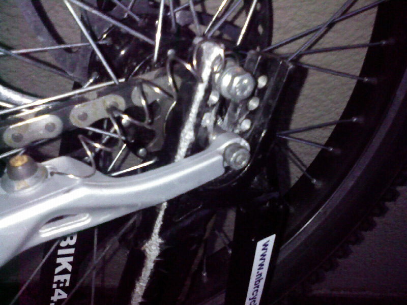

  11. No you wouldn't, my rear wheel would fit in my forks.
  12. Depends really, What size is the rear rim ? What brake are you planning on running ? I've always wanted to build a "19 rear rim onto a front hub

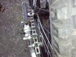

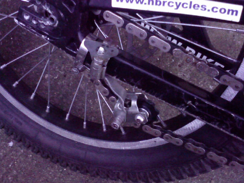

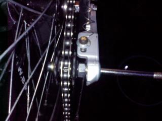

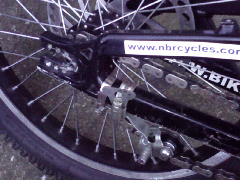

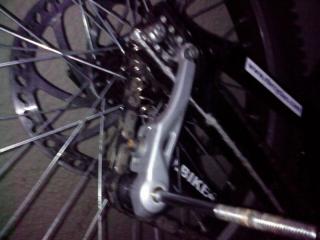

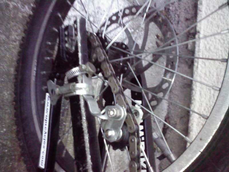

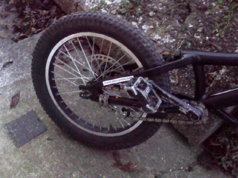

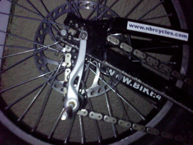

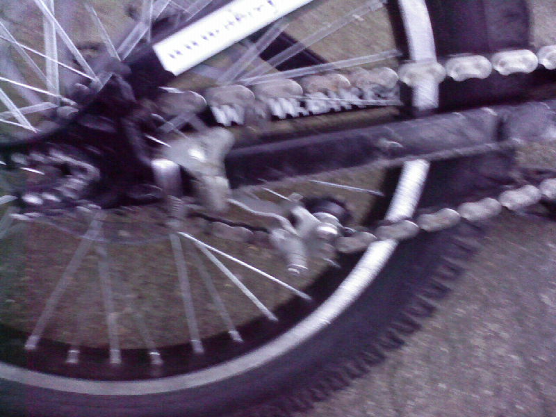

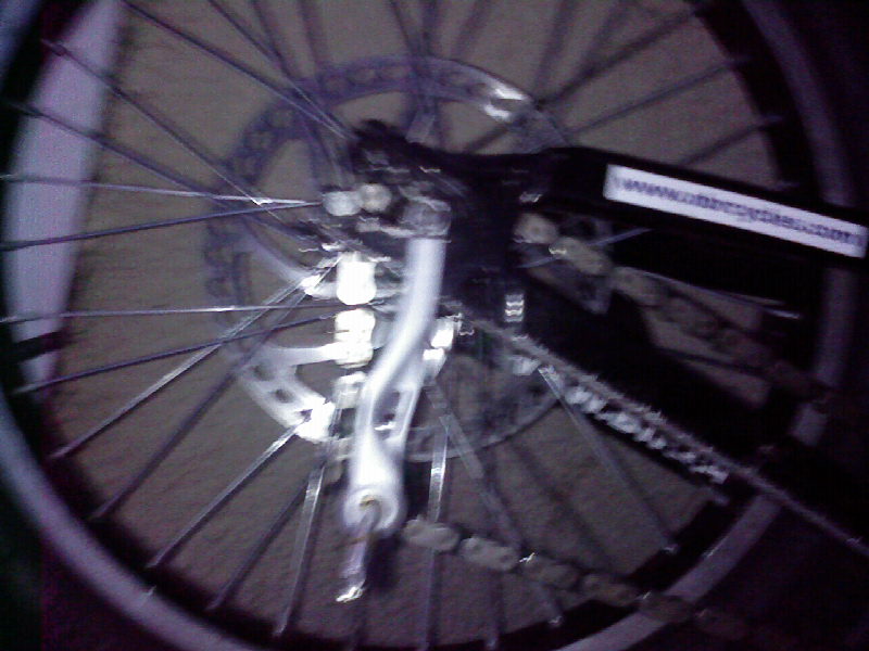

  16. I could take a link out of the chain but that'd be too simple And my chain tool wont work with it I'd imagine it will skip as it is although i'm planning on fixing another jockey wheel so i get a healithier amount of chain wrap, tarty advise 2 wheels with 15t and under, thats a 13 .... After looking at the pictures i realise it sits far too vertical, i'm planning on either Bending the arm so it's closer the the chain stay or Cutting it in half and removing some links It's just temperory until my chain tugs arrive, if i can manage to make something that actually works properly i may keep it just for the crack of it, just got bored and decided to have a fiddle really Didn't help that i had no garage to use so no drills, saws etc, just bits and pieces that i could find Thanks for the comments
  17. Basiacally just a Vee caliper bolted onto the Axel with a jockey wheel attached, need's tweaking but it got dark (hence the shite pics ) It's also got a spring clamped with a bolt where the pad would sit which pully up towards the dropouts. Only problem is the bar the jockey wheel is sat on is far too long and needs cutting down. Excuse the shit pictures, only had a phone handy Edit: i've just realised how long it looks, i am going to shorten it/bend it so it doesnt stick out quite so much.
