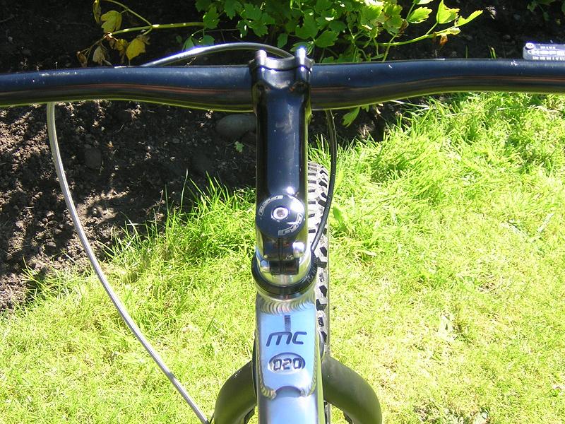

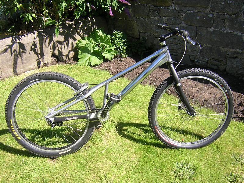

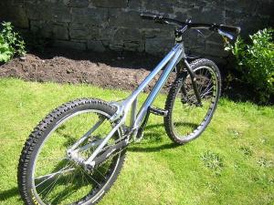

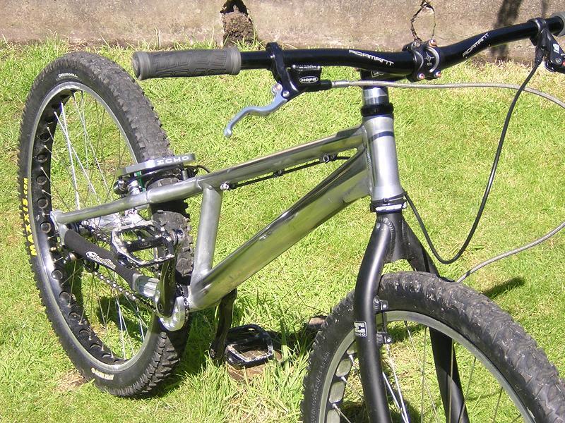

  18. After loads of playing around I've finally got my bike pretty much how I want it. Got a Caisso frame and stripped and polished it because the paintwork was in poor nick. I've polished the front more than the rear, as is obvious from these pics. Every time I start polishing it I end up getting bored and going riding instead. Also got the Heatsink Bash and done the singlespeed thing too. Really liking how it rides, Just need to get out and about more now. Spec is as follows: Frame- Koxx Caisso Forks- Echo Control Headset- FSA Pig Stem- Echo Control Bars- Adamant Front Brake- Hope Mono Trial 06 (180mm rotor) Rear Brake 07 HS33 with Coustsink CNC Pads and Echo Booster Front Wheel- Echo cnc rim on Echo Disc hub Rear Wheel- Chris King ISO on Try-All rim Drivetrain- Middleburns w/ Heatsink Bash and 18t chainring, 13t Surly on the rear Tensioner- Rohloff I'm happy with the bike at the moment. Just going to improve things as i need to. Things in the pipeline are 203mm rotor, Hope (shorter) Stem and a new chain. Thanks for looking guys.
  19. I've got Coust-Sinks with CNC backings and they're absolutely great. You can get them cheaper with plastic backings too.
