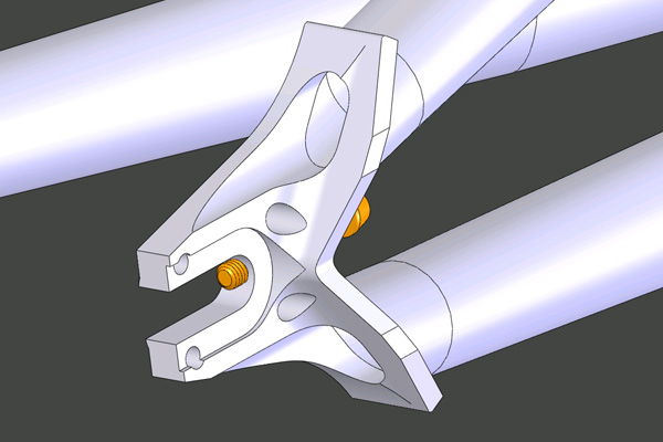

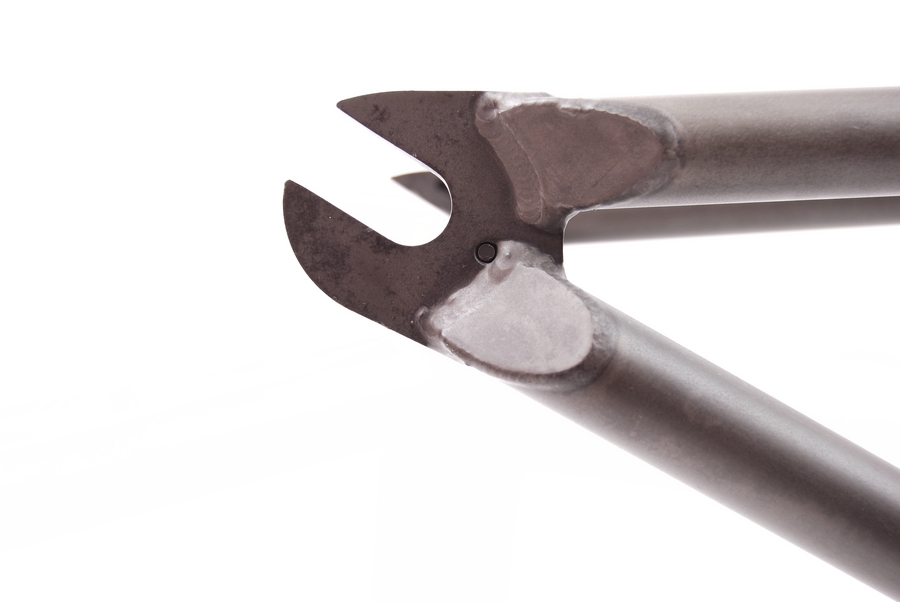

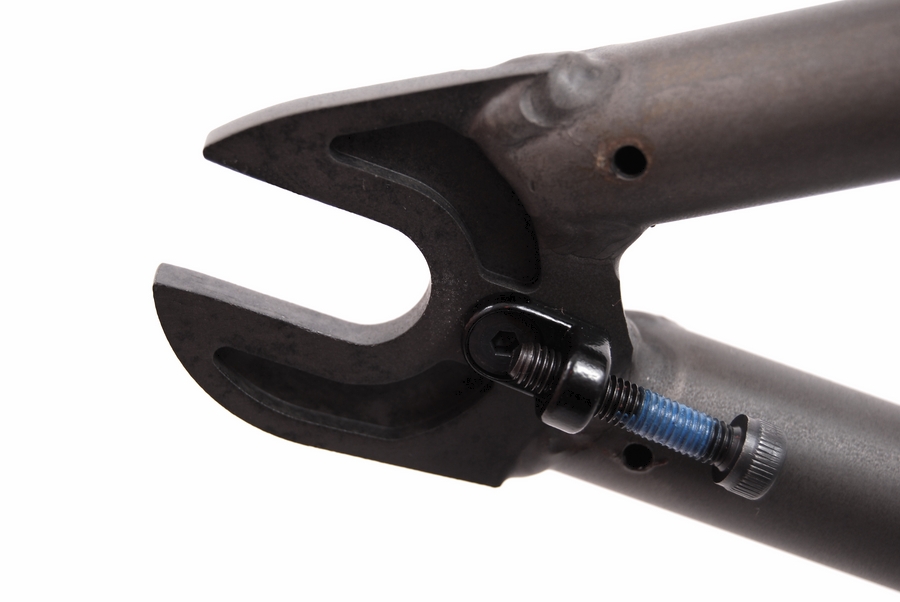

  21. the closest thing (that i can do on my frame) to this: is something similar to this: you think it's worth the hassle ? does it seem more reliable than chain tugs or snail cams?
