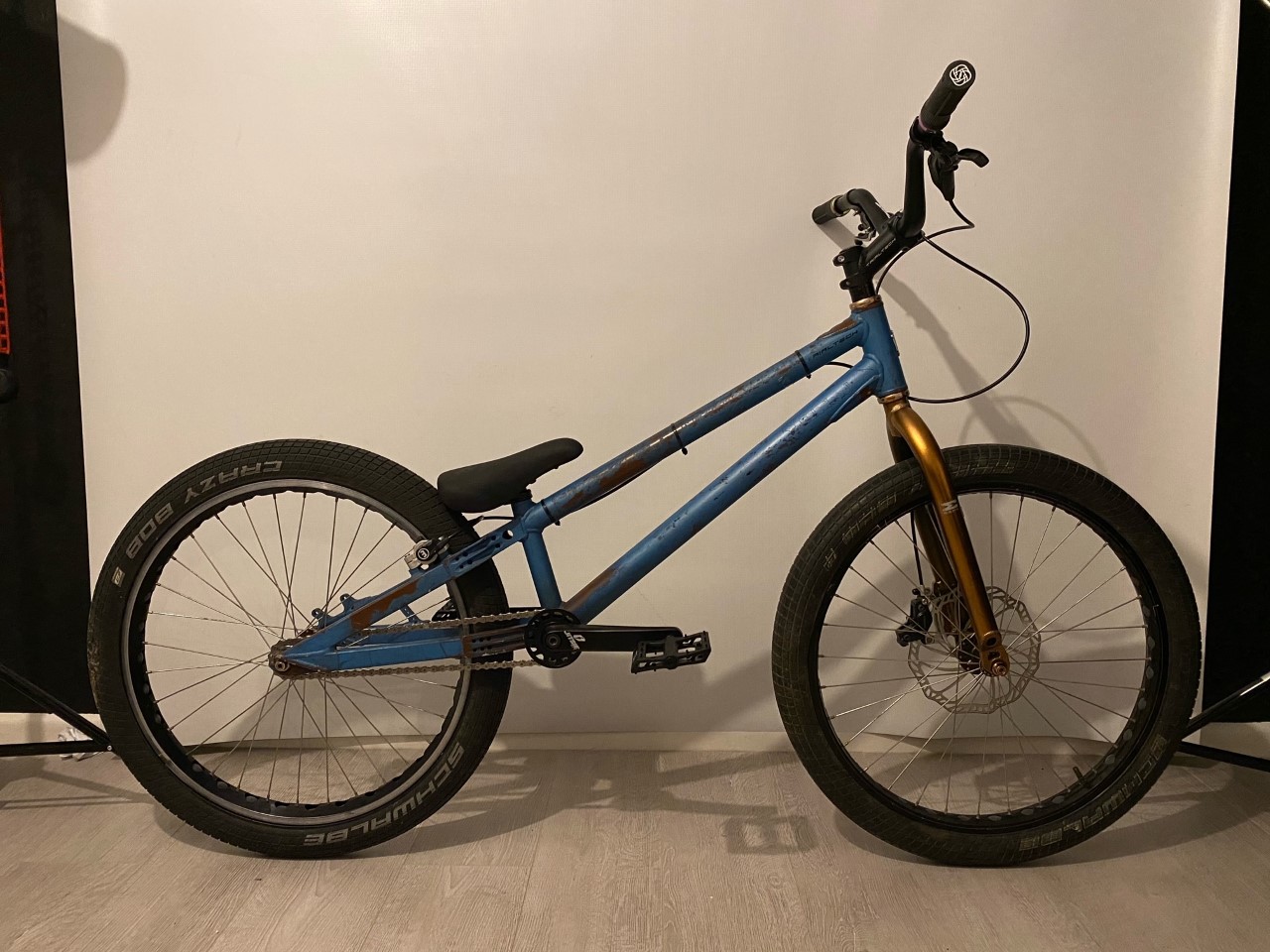

Updated OP with new pics now it is all together with the last few parts
I would think they're very similar if not the same. The rear disc mount definitely sold it to me, just need to swap the hub over for a disc hub so I don't have to run the magura. I bled it twice yesterday and I still cannot get the damn thing to work. I have no idea on the geometry, I struggled to find anything that was for this year of frame (think I narrowed it down to about 2011 ish?). I'll get the tape measure out at some point and see what it is. From looking at the pics, I'd say your Adamant is maybe a touch longer?
It's nuts isn't it!! I spent so long looking at the picture going "You twat, you've put the forks on backwards...." then I looked at the bike and realised I hadn't. As you say it's a really weird optical illusion!!

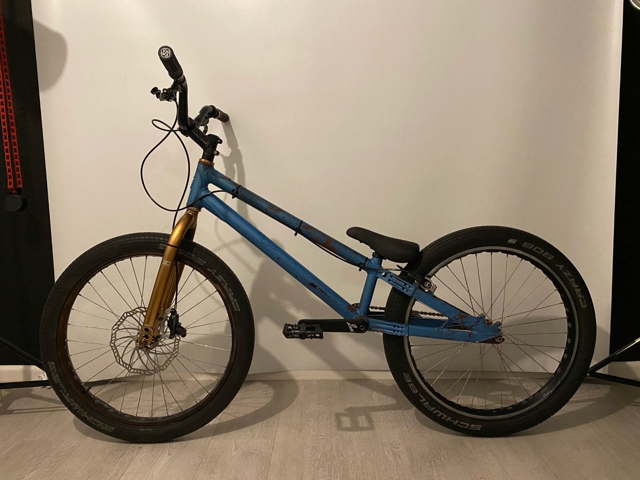

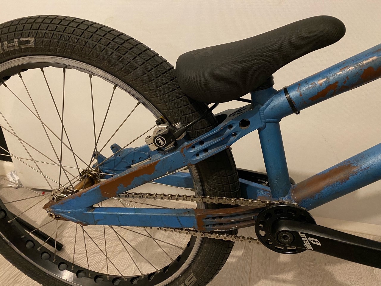

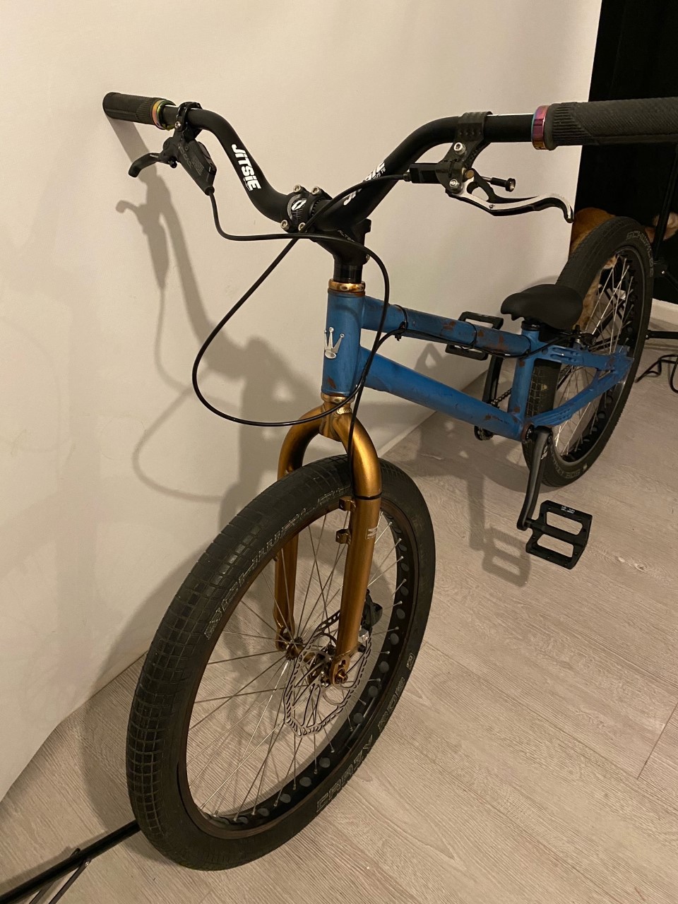

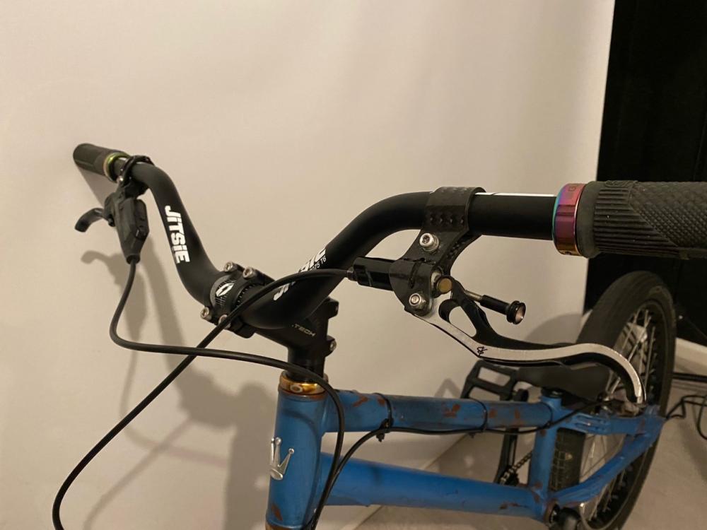

The "prom-night dumpster baby" project build is underway. I know it looks like a s**t heap right now; it'll get blasted and painted at some point when the weather improves. Update - Now got the brakes on and set up, along with a different seat and some replacement bolts around the place as some were gash and rusty (although fitted with the current theme). Oh and I changed the front rotor so people don't think I bought the bike from Argos Czar 24" frame Echo Urban forks Trial Tech stem Jitsie Hybrid bars Echo BB Jitsie cranks and freehweel Echo wheels Schwalbe Crazy Bob tyres Sram Code R front Magura HS33 with RB Designs lever rear (I wonder if they still leak like they did in 2004...) Alone Big Dick tripod seat and post
