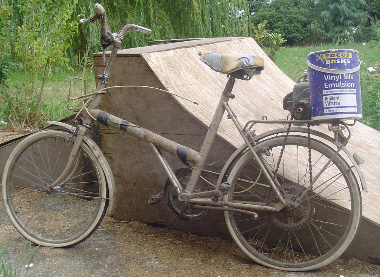

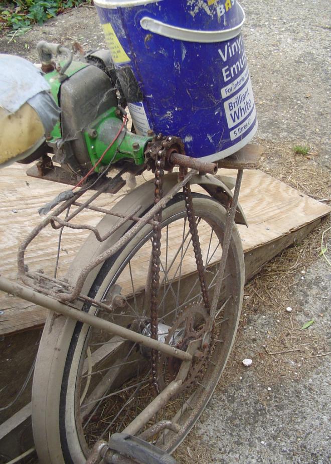

CurtisRider Posted August 4, 2006 Report Share Posted August 4, 2006 (edited) [attachmentid=6304][attachmentid=6305][attachmentid=6307]did this about 5 years ago, just got it out of the shed for you basically i welded a sprocket to the sturmy rear hub (steel shell you see) and made some mounts for the engine on the rear rack it had a centrifugal clutch which was handy anyway, quick few pedals and whack the engine on and away you went...well kinda :$dunno if thats of any help to you, but it was alot of fun to make and dont ask about the paint tin bolted to the back, i dont have a clue either think thats where the fuel tank was mounted on top of in the end Edited August 4, 2006 by pauloliver Quote Link to comment Share on other sites More sharing options...
