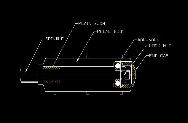

forteh Posted April 14, 2008 Report Share Posted April 14, 2008 Sounds as though there is no locknut holding the bearings on to the shaft When you say the outer bolt, do you mean the end cap on the pedals? On dmr V12s this was needed a 6mm allen key to undo it and there was a separate locknut underneath that held the pedal onto the spindle, if the locknut has come loose the pedal body will be able to move on the shaft.This is a quick autocad sketch I did showing a rough section through a pedal, in this case a dmr v12 with a ball race on the outside and plain bush on the inside - I suspect the atomlab pedals are similar.If you take the endcap off is the locknut tight? The locknut holds the ball race onto the shaft and the end cap holds the ball race into the pedal body. Check the locknut is tight, if it is and the pedal body can still move with the end cap screwed in then there is probably a manufacturing or assembly defect Quote Link to comment Share on other sites More sharing options...

1a2bcio8 Posted April 14, 2008 Author Report Share Posted April 14, 2008 (edited) Sounds as though there is no locknut holding the bearings on to the shaft When you say the outer bolt, do you mean the end cap on the pedals? On dmr V12s this was needed a 6mm allen key to undo it and there was a separate locknut underneath that held the pedal onto the spindle, if the locknut has come loose the pedal body will be able to move on the shaft.This is a quick autocad sketch I did showing a rough section through a pedal, in this case a dmr v12 with a ball race on the outside and plain bush on the inside - I suspect the atomlab pedals are similar.If you take the endcap off is the locknut tight? The locknut holds the ball race onto the shaft and the end cap holds the ball race into the pedal body. Check the locknut is tight, if it is and the pedal body can still move with the end cap screwed in then there is probably a manufacturing or assembly defect There is only an end cap, no lock nut whatsoever. The end cap holds everything together. That, it would seem, is the intended design... Edited April 14, 2008 by rowly Quote Link to comment Share on other sites More sharing options...

forteh Posted April 14, 2008 Report Share Posted April 14, 2008 There is only an end cap, no lock nut whatsoever. The end cap holds everything together. That, it would seem, is the intended design...Bit of a shite design then Quote Link to comment Share on other sites More sharing options...
