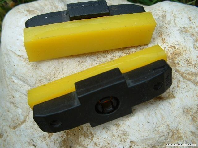

First set of home-made pads
Heatsink
After a period of research, I got hold of some material which the best evidence available had highlighted as the very same used for Koxx Bloxx. Then I made these pads up to test their performance. No messy screws required, pads snuggly imbedded into the backings so only glue was used.
All I can give away is that future versions will have 8mm of pad rather than the 6mm on these.
20th June '04:
Took the Koxx Bloxx out of my rear brake and compared the material softness to my homemade pads. Although I don't have a durometer to measure the hardness, I have got hold of 9 samples across the hardness range, and I was pleased to see that the material I've used appears, in my limited subjective comparison looking at deformation with a point, to be of equivalent hardness.
Fitted the new pads to my bike (fortunately I didn't need to set the brake up again since they have the same amount of material on them as the Bloxx - so everything in the braking system has remained unchanged for a fair comparison) I found they behave the same as my Koxx Bloxx smile.gif Locking up with exactly the same ease, which helps my cofidence on the bike. I'd already roughed up the braking surface on the pads so they visually looked the same roughness as my Bloxx after being run for a while against a ground rim. I'm well chuffed they work! I need some new pads for the front, but the thought of buying another set of Koxx Bloxx was getting painful!
June 25th:
More pad material ordered so I can make pads up for other people to test...... I've been waffling away about how they work so well, but to be truely objective I need others to give them a try too.

Feedback from Jon:
"Update...
Still got good lockage on my dying grind. They were working well enough to manual down the hill at Tech in the rain. Not sure if they've worn much either. I'll refresh my grind sometime soon and see what difference that makes.
Bottom line is that they're easily as good as Bloxx
Jon"
