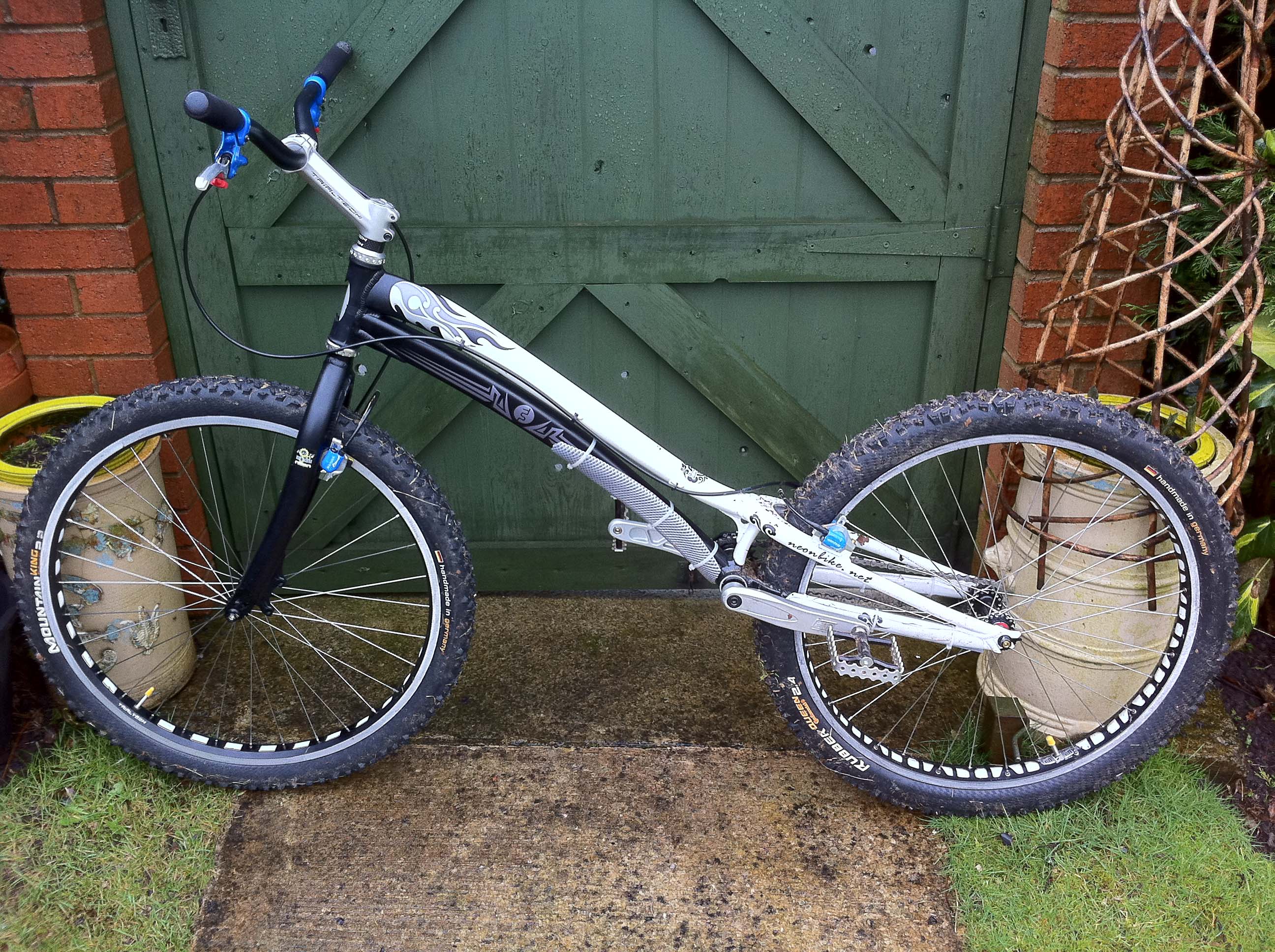

OAP Posted February 26, 2011 Report Share Posted February 26, 2011 Here is my pride and joy. I'm not too keen on the funky graphics and the front V!Z pads. But it rides great. All parts supplied by Tarty. Frame – Neon Bow 26 2011 Wheelbase: 1095mm Chainstay Length: 380mm BB Rise: 45mm Bottom Bracket -Trialtech Sport Lite ISIS with Bolts. Headset - V!Z sealed Forks – Neon Curved Blade Stem – Trialtech sport forged high rise 130mm x 25deg Stem Spacers - Trialtech carbon 10mm + 5mm. Bars – TryAll high rise riser. Grips - Rockman foam. Freewheel – Tryall 108.9 18T Rear sproket – Echo splined 15T Cranks – Tryall ISIS 175mm Pedals – Echo TR Caged Chain – Trialtech Z610 HX 3/32. Half ring – Neon Bow. Snail cams – Rockman. Brake Clamps – Echo SL. Brakes – HS 33 (pre 05) Front Pads – V!Z yellow (not too good) Rear Pads – Heatsink Coust on CNC backings (love em!) Rear rim - Atomz/UN elitis Front rim - Trialtech squared holes. Rear hub - Echo SL. Front hub - Echo TR non disk. Spokes - Sapim race silver. Rear Tyre – Continental Rubber Queen. Front Tyre – Continental Mountain King. Trialtech rim tape Continental MTB tubes. Weight 8.76Kg Quote Link to comment Share on other sites More sharing options...
Sam T Posted February 26, 2011 Report Share Posted February 26, 2011 Always liked the look of Neon frames. Although, your leaver postitions are crazy. Do you find it comfortable like that? 1 Quote Link to comment Share on other sites More sharing options...
Luke Dunstan Posted February 26, 2011 Report Share Posted February 26, 2011 That look stunning, I do like those frames in back/white, the red ones look horrific. And its 3kg lighter than my 24". Nice . Quote Link to comment Share on other sites More sharing options...
OAP Posted February 26, 2011 Author Report Share Posted February 26, 2011 Always liked the look of Neon frames. Although, your leaver postitions are crazy. Do you find it comfortable like that? Yeh they do look a crazy angle. I adopted that angle originally to help keep my elbows in and down when on the rear wheel and I have just got used to them like that I suppose. Old habits and all that...!! Quote Link to comment Share on other sites More sharing options...
